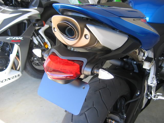

I have recently started making some fender eliminator'sfor theRR's, its really not that hard. but
if you dont have the tools or time or materials, and would rather just pay somebody a small amount, I would gladly
make one up and ship it out to you.
shoot me a pm if interested.

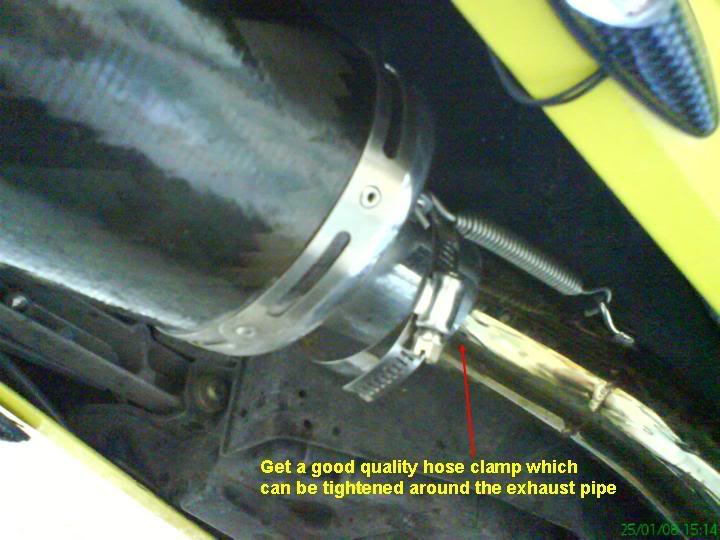

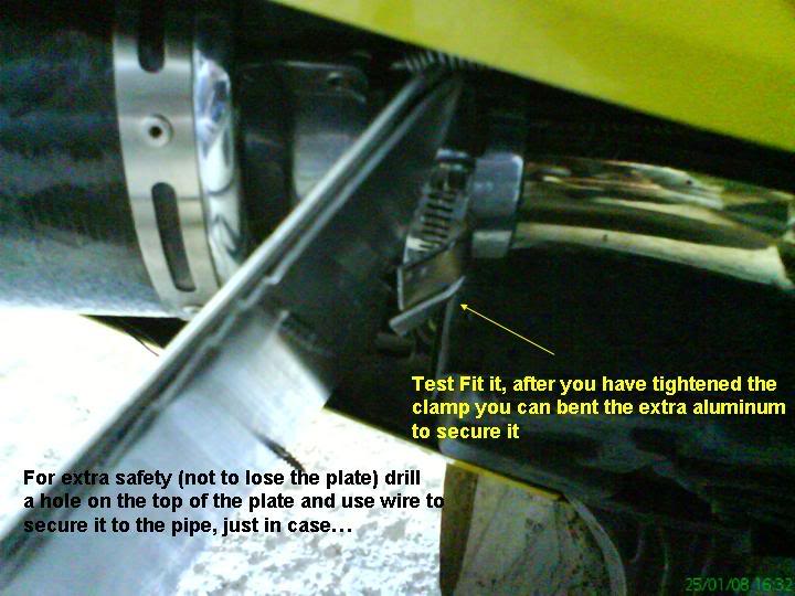

Here is my try:

NIK, I like your idea of using a clamp to secure a custom plate mount to the exhaust pipe...I think I'm gonna go with a similar concept using LED bolts.

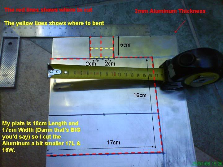

Just a thought, use 1mm thick aluminum because 2mm when you bent it it tends to tear little by little instead 1mm which is more flexible.

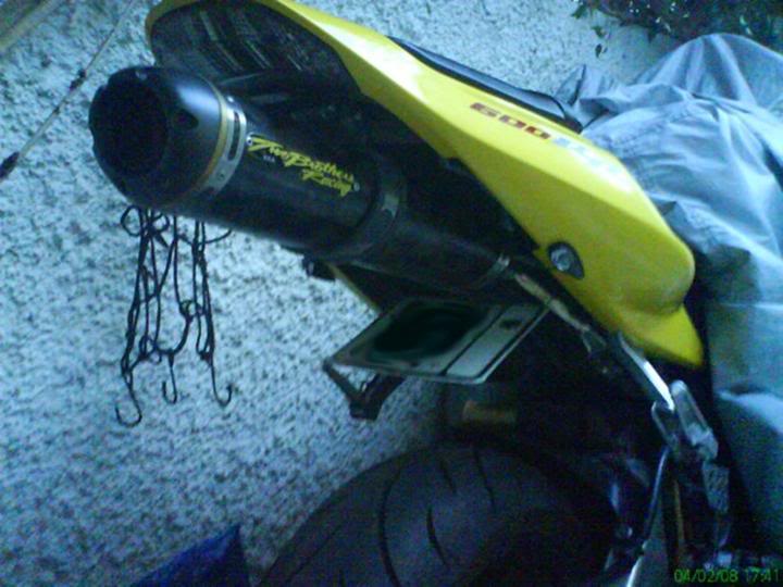

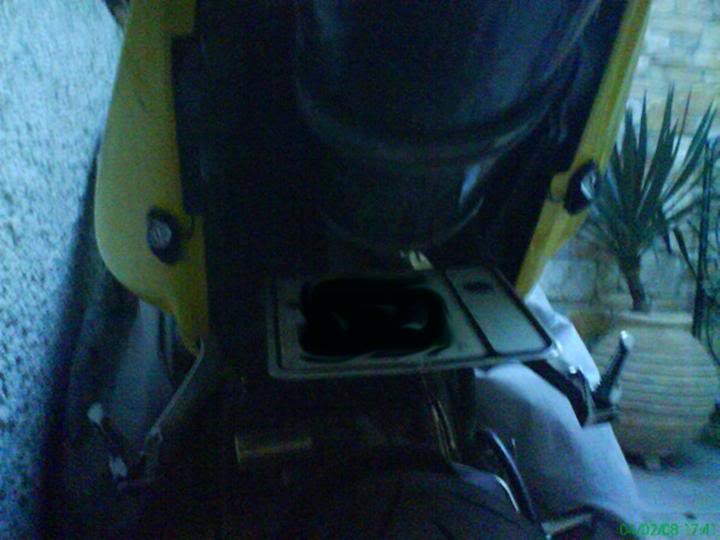

Forget the previous, Here is another try for license bracket easier & looking better:
1st find the plastic around the battery cover, there you will bolt on the bracket

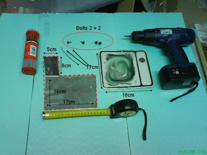

2nd measure your license plate diamensions, mine is 17cm x 18cm, get a 2mm thick aluminum and cut it like this and a bit smaller than your plate,
put your plate on top of it and mark the holes of the plate, drill the 2 holes for the plate and another 2 for bolting
the bracket on the plastic(pic1) and another 1 forcabletie (just for extra safety)

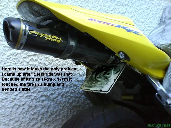

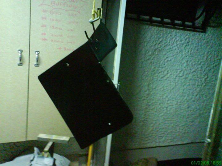

3rd attach the plate on the bracket, test fit it on the bike and center it, you can bent the aluminum as much as you like, be carefull to have a safety distance from the tire
4th round the edges and paint black
5th bolt on the bike, and use cable ties for extra safety(not to loose the plate) Also you can hot glue the back side
of the plate bolts
It's barely visible from the side!!!!!
