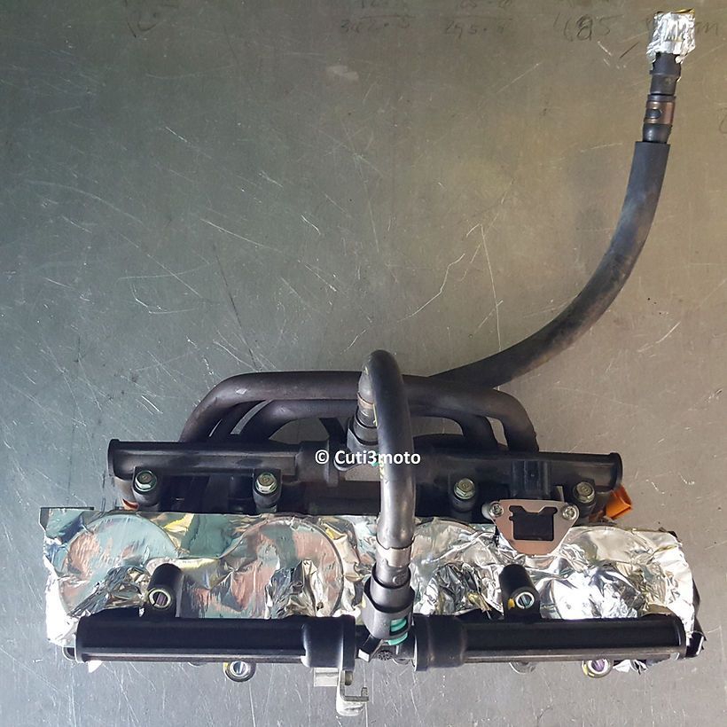

My throttle bodies and secondary injectors showed up – packaging for them in the available space will also be tight, but do-able.
The shippers didn’t put the foil tape on either of these items.
I did that to keep cosmic debris out of the delicate bits.

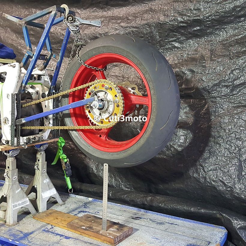

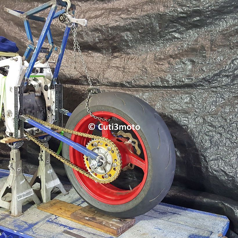

Gurty suspension movement mock-up - designed with 300mm front and rear, minimal change in chain tension, and anti-squat characteristics through the full range of motion.
