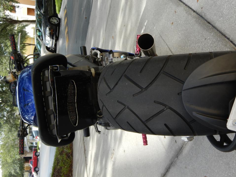

Here are the pics of the finished bike

More pics

18 inch rim?
It looks good, I like it
