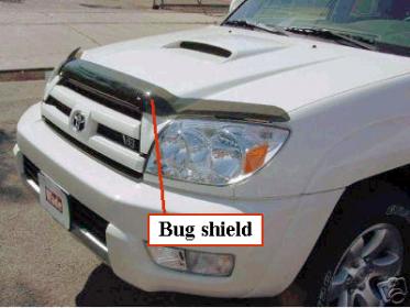

As far as the windscreen goes I may mould a piece of polycarbonate in kindof a lip to bolt to the top of my stocker, I like the idea of getting a little air gap in there to break up the turbulence. Then again it was pretty comfy as is. Ear plugs would have helped the wind noise but buffeting wasn't bad.

As for the lip on the screen, Kiwi TKs bike has a Toyota something or other bonnet protector shaped slightly (by brother Kiwi JK) and screwed on. I'm 5'10" and had no buffetting at all.
You can see it quite clearly in this shot.
Cheers, SB

Yeah that's what I was thinking, nice windscreen mod! I may do that if I go with risers.
Thanks for the compliment, but all credit for that particular Kiwi, cheap **** invention has to go to kiwiJK. One of the utes at his work came in with a cracked bug deflector which was replaced with a new one.
Cut down the old one, bit of careful work with a hairdryer/heat gun to get the shaping right and there you go. Robert is your fathers brother.
Worked so well that after he made one for his own bike, he got all carried away and made one for me as well.
Visit your local auto wrecker, you can probably pick one up for less than the price of a beer.
Attached Thumbnails First day trip on the 1kF, couple observations-bugshield.jpg

Nice, looks like I'll be keeping my eyes open for a cracked bug deflector. I like the sound of the 18t sprocket too, I would rather run first gear out a little further anyway so I'll just readjust my shifting a bit. The way I ride I doubt it will really make a difference.
