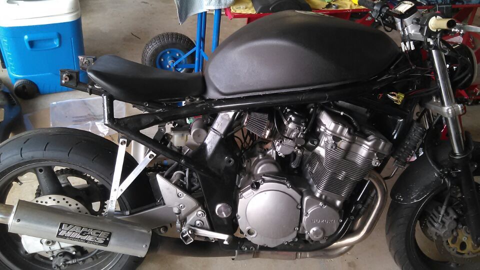

Here's a pick of what its going to look like
Its a 600rr tail. It'll double as a battery tray with the CDI and fuse box.
Its certainly not a world beater, but for $800, its going to be a fun little bike.
I painted the tank in bedliner, I'm going to gloss paint the frame black Long with the swinger and triple (theinly thing that won't be black will be the motor.
If I have enough left over and can find them cheap enough, I might throw a set of early 90s/80s gsxr cams in it as it should give it a bit more grunt.
I'm going to ride it until my bike is done and then probably sell it (2 friends have already said they want it so I'll be able to get rid of it easy).
When I get the chance, I'll put up a pic of how it was when I brought it home. It wasn't pretty, but I think with a bit more effort, it'll be a decent ride, at least mechanically speaking, if not aesthetically pleasing.

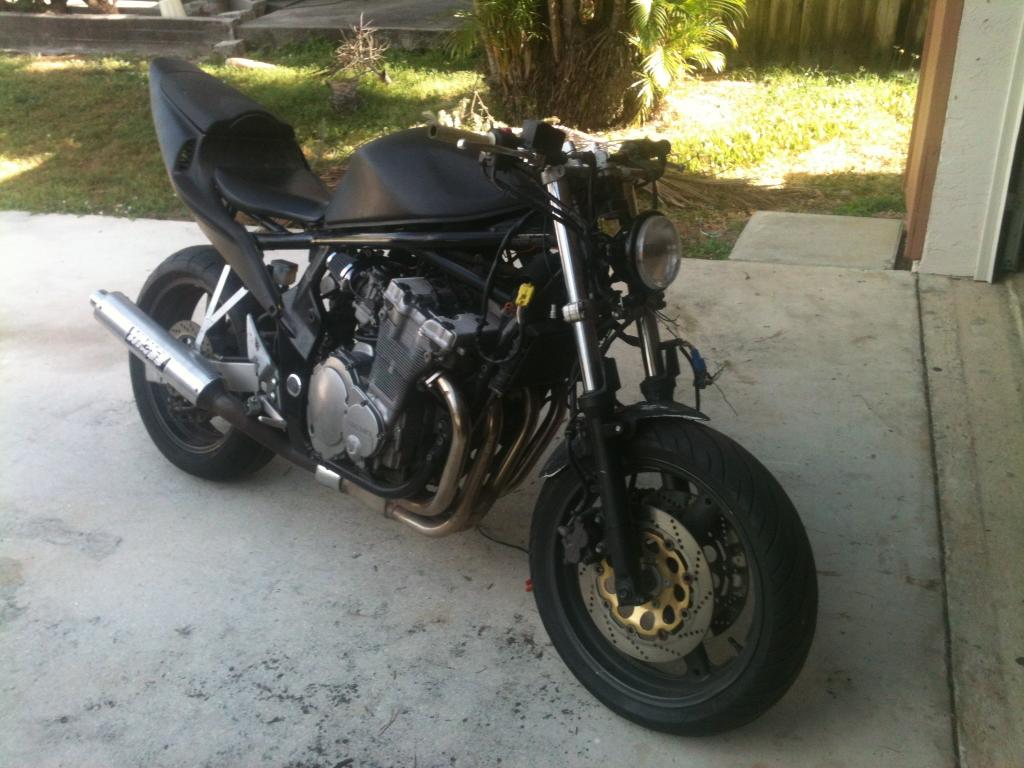

Oh, the choke cable was broken, so I deleted it. Im going to make a nice little lever for choke on the carbs.
The wiring is/was a mess. Wire nuts (and just electrical tape in some cases) held everything together, and the guy mistakenly wired his acerbis through the guage wiring harness, so nothing worked like it should and most of the wiring was corroded. But I've almost sorted it.
Question
I have the trailtech hooked up, but this bike runs wasted spark, so no matter how I run the rpm signal wire, it reads 2X the revs its supposed to. Any idea on how to fix this?
Old Jan 9, 2015 | 12:07 PM
74demon's Avatar
Posts: 12,193
Likes: 119
From: socal 949/951
That tail sits pretty stink-buggy. Maybe its just the pic...
If you raise the exhaust and match the tail angle, it might look better.
Does the tach have a setting for an 8 or a 2 cylinder? One will cut the signal in half, but I forget which.
Old Jan 9, 2015 | 03:35 PM
Conrice's Avatar
Posts: 6,146
Likes: 37
Okay, so I broke down and read some instructions (what a concept...). Trail Tech goes by Pulses Per Revolution, or PPR, and is adjustable from .5 to 2. Running in wasted spark puts me at 1 since its a 4 stroke, so we'll see how it goes. It doesn't configure based on cylinder count, which I thought was odd.
And that fairing is literally just sitting on there. I'll post a pic without to show you the PO`s angle-grinder-fever. There is a 1/4 inch thick steel plate that the rear of the seat bolts down to, and the rest rearward of the frame is essentially hacked off. I'll play around with it for sure. But the bobber thing just doesn't do it for me.

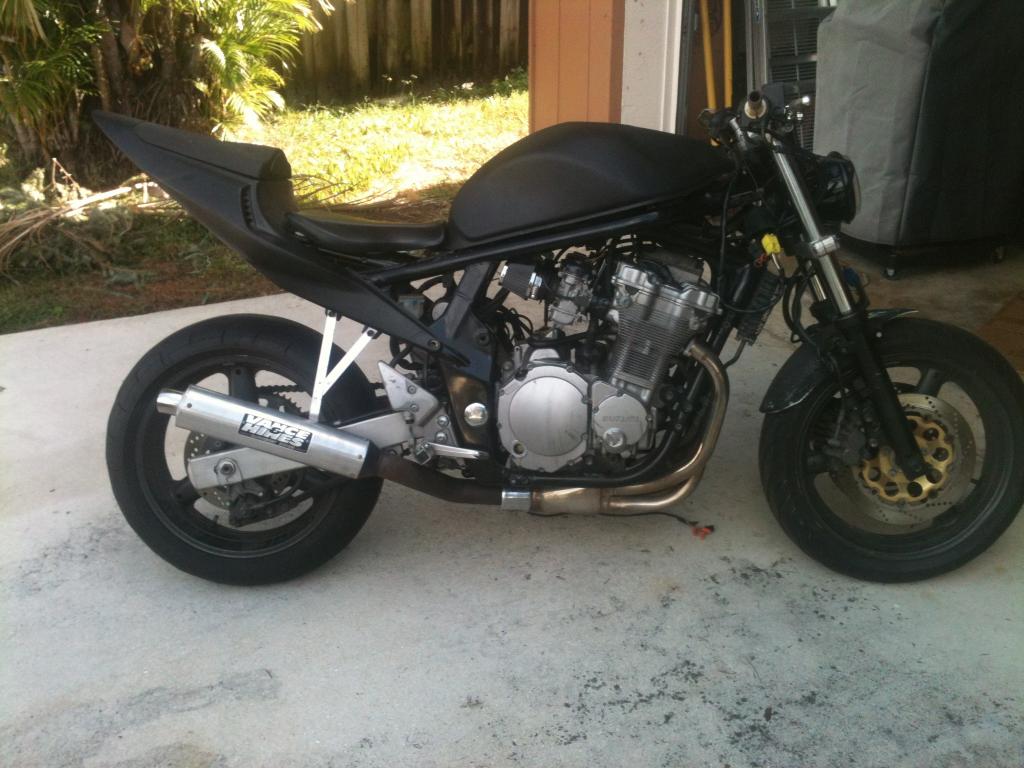

That's the guy's attempt at a bobber....
So I'm going to build onto it, and you can see how the 600rr fairing flows with the bottom bar of the frame.
Old Jan 10, 2015 | 04:23 PM
Posts: 7,178
"She's a beaut Clark!"
Gotta say i like your version just a little bit better.
Old Jan 10, 2015 | 04:39 PM
74demon's Avatar
Posts: 12,193
Likes: 119
From: socal 949/951
Why not fab a tail section out of thin steel? Make it look like some of those custom bikes in the interesting bike pics thread.
Do you have a welder?
Old Jan 10, 2015 | 05:23 PM
Conrice's Avatar
Posts: 6,146
Likes: 37
I have access to o/a, and a 110 MIG with gas set-up that I've used before. I could do that... I didn't really think about it because I just had those parts laying around....
Its not as if there isn't a ton of inspiration in the interesting pic thread...
My fab skills are getting a bit better as far as sheet goes. And there were going to be issues with the 600rr tabs for the pillion cover that would be eliminated. I think I'll work on that idea. I have a ton of spare taillights laying around too.
