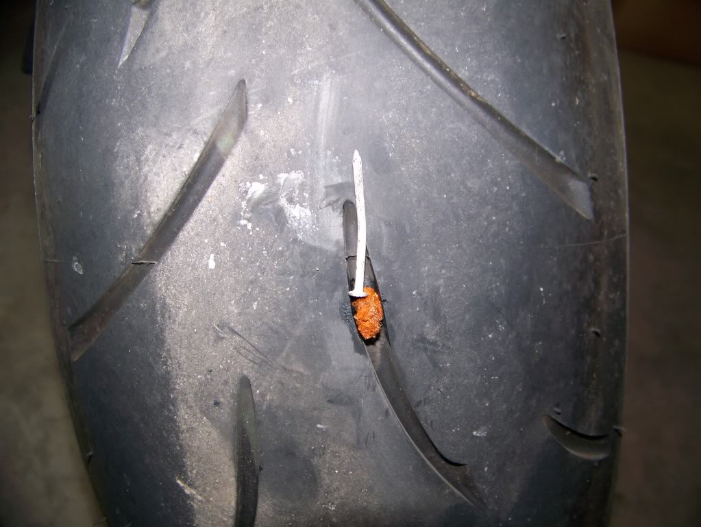

I plugged mine but it kept leaking. I didn't bore it out cleanly enough. Guess that makes a big difference. Removed the tire and put a mushroom patch on the inside and have had 0 problems since. It's not a big deal if it's in the center of the tire. If I took one in the sidewall, forget about it!
