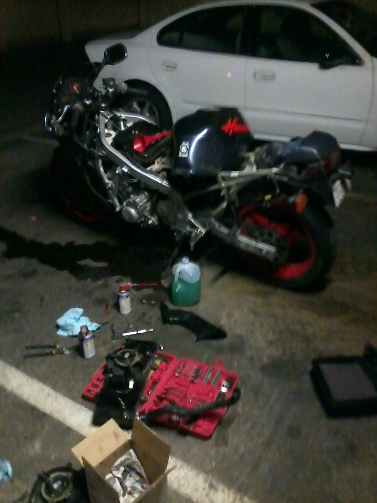

An '88 Honda CBR600FJ with 42k miles
I got it for exactly how much I sold the Blast for. As far as I know, the engine was rebuilt at 40k, it has a K&N filter, and the exhaust is chopped. In comparison, the Buell Blast was like a toy.
Sadly, the cooling system was shot so the engine overheated really quick.
The problems I fixed were:
Broken pipette from the radiator filler neck leading to overflow tank.
I bought a replacement and used a plastic welder on the current one.
The cooling fan had a broken blade so I replaced the entire thing anyways.
I have not been able to find a thermostat yet, so it's running without one. I finally got a used one for reference though.
The sensor that turned on the fan wasn't working so I made a manual bypass switch instead of shelling out even more money.
(I did most of those repairs at 2am because LOL COLLEGE)
After getting all that stuff done, I added a coolant mix consisting of
40% Coolant
50% Water
10% Water Wetter
and did all the necessary stuff to get rid of air pockets.
I finally turn on the engine, let it warm up and take it out for a ride and...
it still overheats
The manual fan switch really helped out though.
I finally gave up and got a mechanic's opinion who said it might be the water pump malfunctioning.
On the freeway the temperatures holds steady at a safe range and everything works perfectly, but besides the cooling system I need new tires and the fork seals re-done. In conclusion, I really enjoy riding this bike and will definitely keep it for a long time. I even named her Juliette

First off, welcome to the forum. Sounds like you have quite the project there, although it is one cool bike that it not often seen on the roads. We have a great tech section below for those bikes.. but Im thinkin you need to put a thermostat in there.. without it, water and coolant are simply cycling in and out too quick to be cooled by the fan and radiator...
welcome...
+1, put a thermostat in there. not only does it slow down the coolant for the radiator, but it slows it down for the motor. heat transfer to and from the coolant takes time. the coolant needs to stop long enough for all this to happen. if you see the water flowing with the tstat out, and the system gets hot at all the same time, the pump is working. but it may not be a bad idea to replace it anyway due to age.
