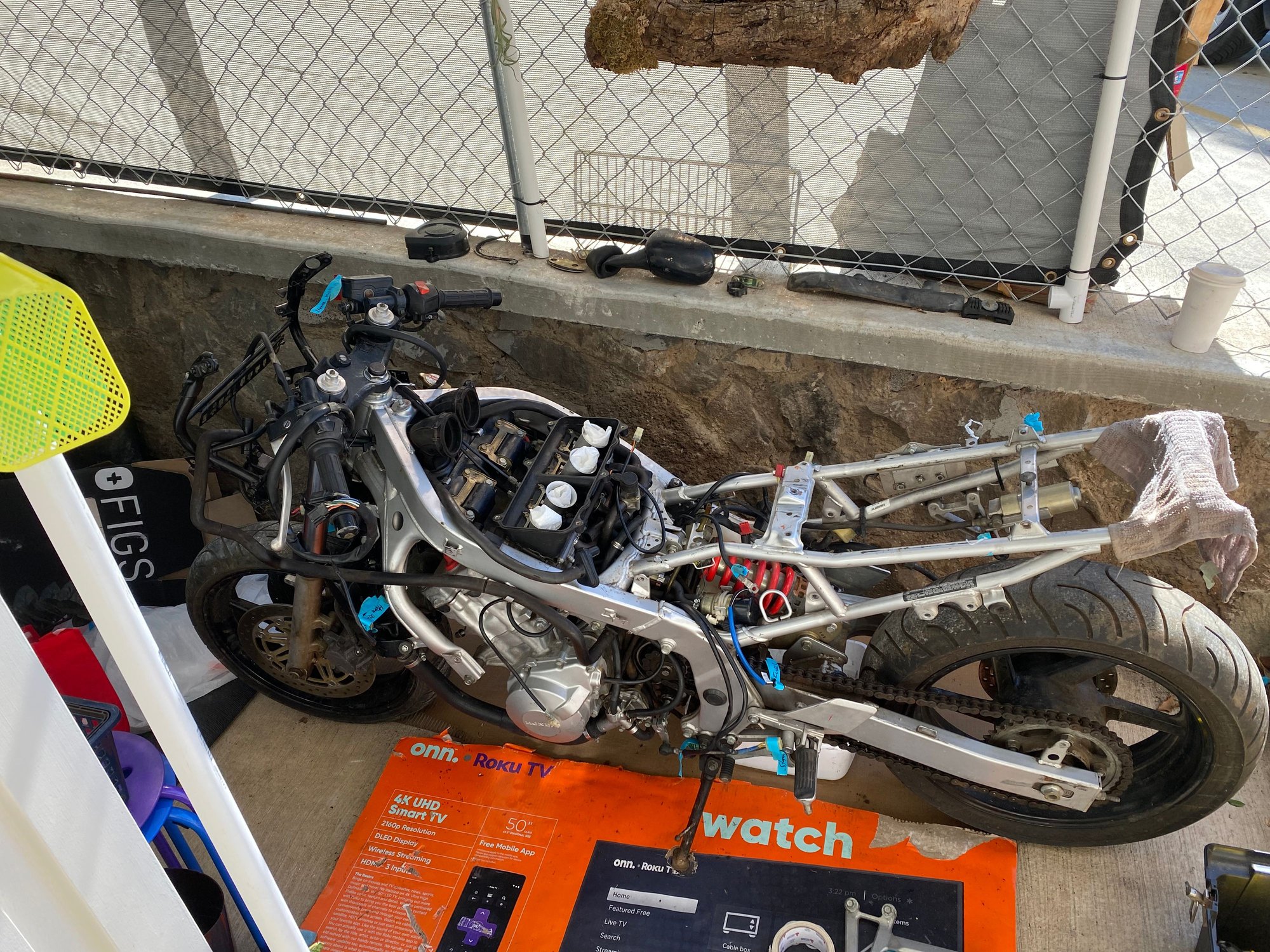

Default Tear down

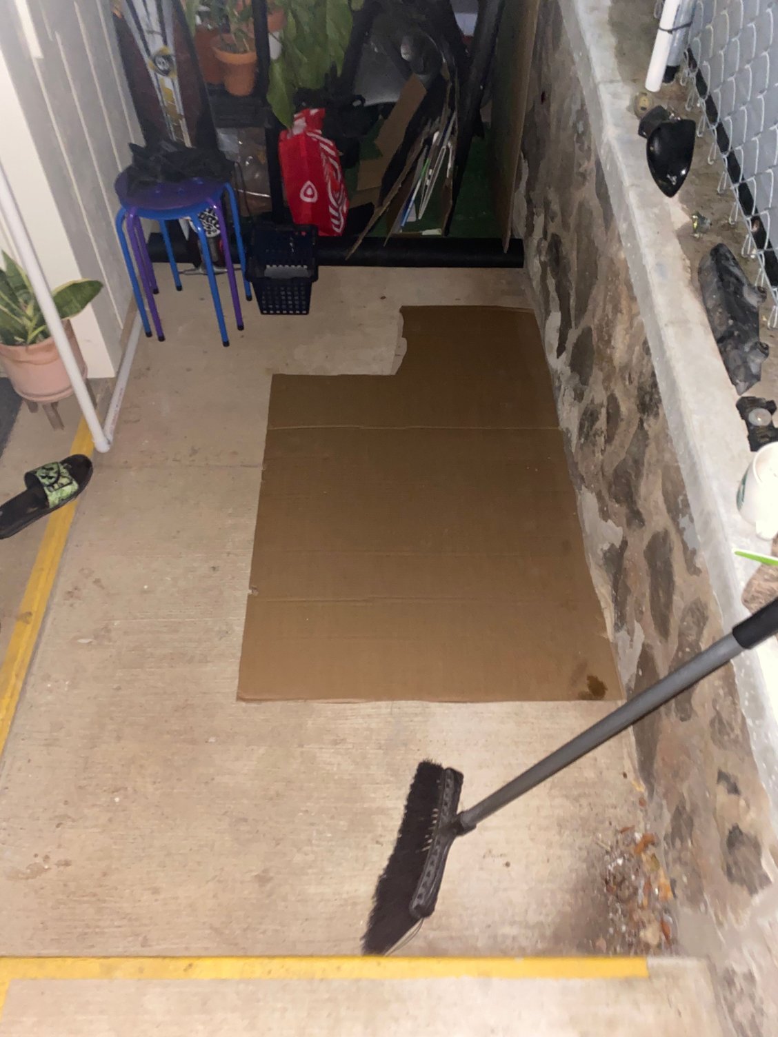

Not much space round here, I do have a semi covered flat surface 7’x3.5-4’ also used a shower curtain overhead for block the rain

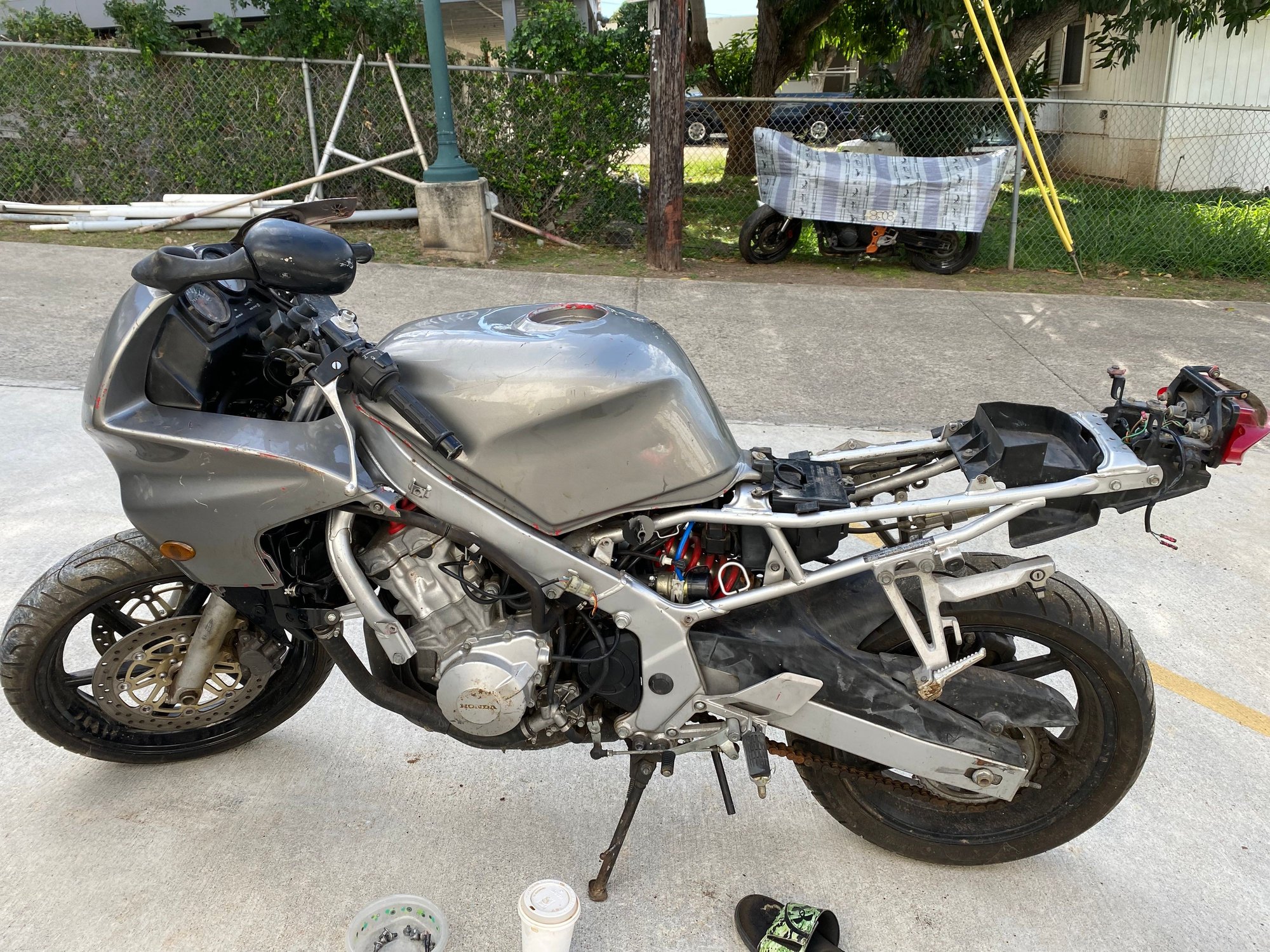

Noticed the fender with tag holder was cut off already.

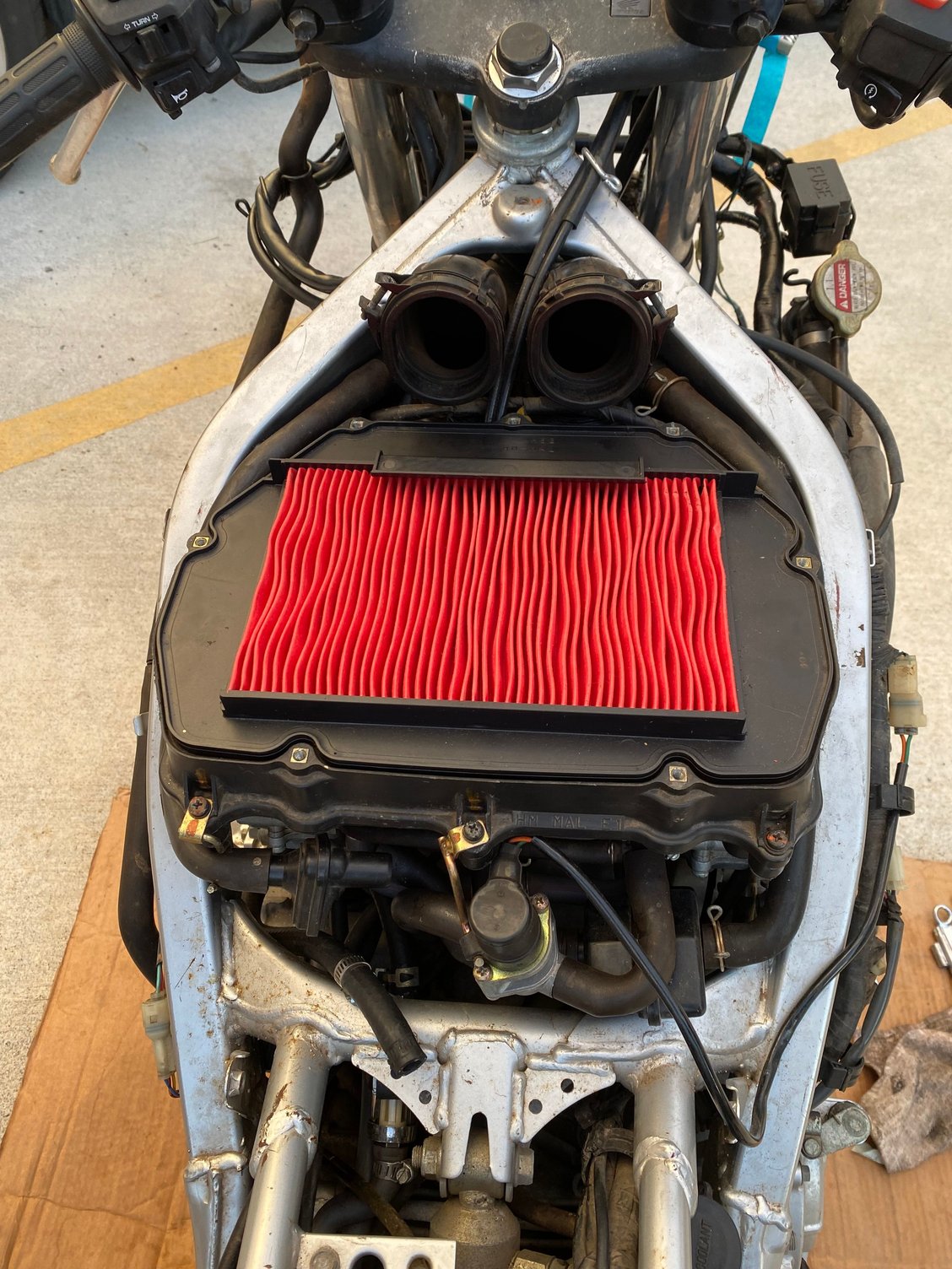

Beside the filter crumble the air box looked great

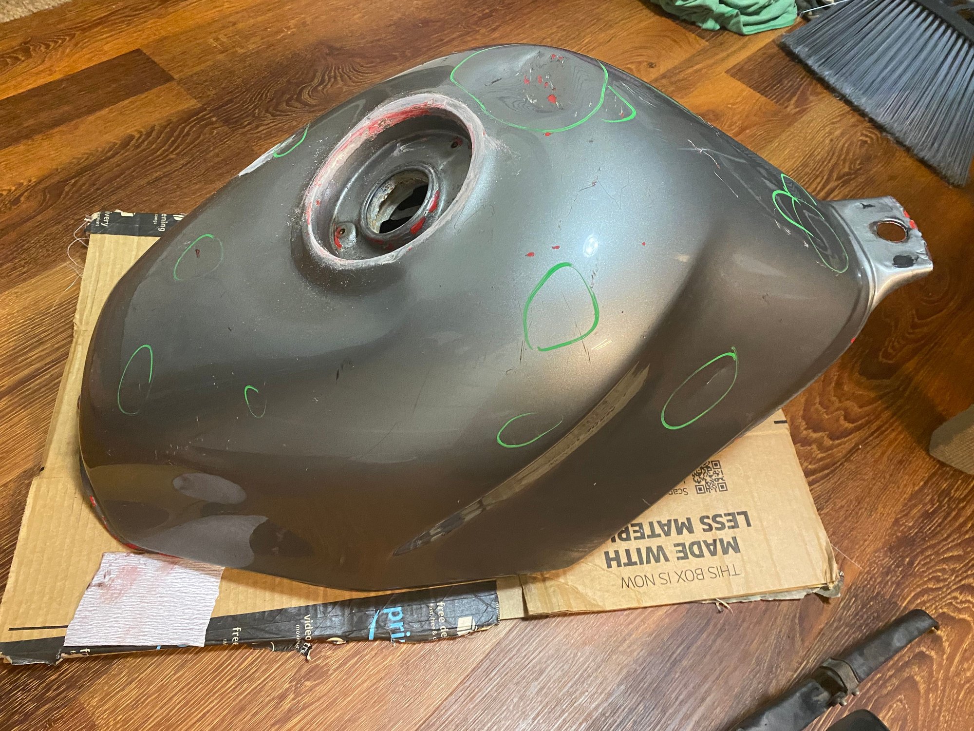

Pretty much all the foam is rubbish already
