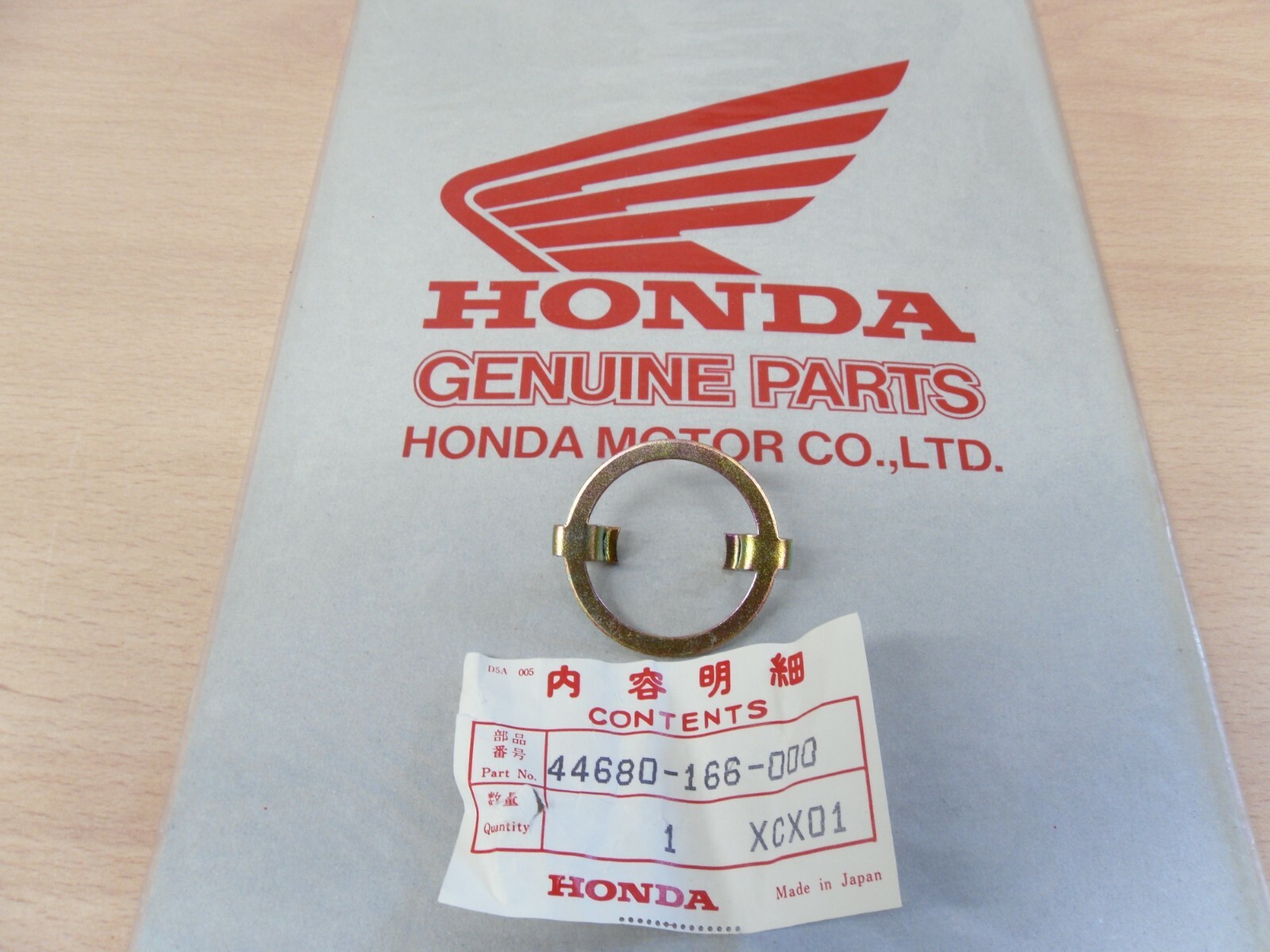

Hey there guys just signed up to this site in hopes of getting an answer/name to a part,
I recently bought a honda cbr 125 needed some work doing, bulk of it done,, my mph clock isn't working I bought a new cable took the driver off and checked it checked the clock and all was working apparently there is a metal bracket of some sorts that sits in the front wheel and clips/attaches/ or works with the speedo driver, I can not for the life of me find one I can only find a speed driver and not the metal bracket, can any of you guys/girls out there help me out with this mysterious part and the name of it or even where I can find one as am totally lost here,,

hi. i assume your are referring to the part #7 here. i'm not 100% sure about the exact name but i guess it's the speedo drive gear retainer. something like in this picture.
Thank you for your reply and this is the exact part I was on about I was told I needed this part but was never given a name, I really appreciate you helping me out kind sir has made my day
