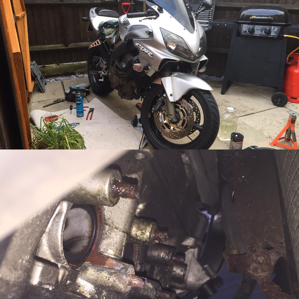

Any way, had it for just over a year, and it just scrapped through it's MOT last month with a slightly blowing centre box, so bought a new Delkevic downpipe and collector set to compliment my Delkevic back box, I'm no mechanic but can do routine stuff / minor servicing etc and though how hard can removing eight studs be .... well it all started fine, first two came out with no issue at all, basically i snapped off all remaining six
And the FS is looking pretty sorry for itself.
Tried literally everything, soaking in WD40, heating up, shock and unlock (freezing spray), dremeled, we've worn out stud extractors, my Dad thinks they are hardened steel studs so we've got two hopes drilling them out in situ, before I embark on being raped by my local motorcycle mechanic are there any other options, I have a feeling the engine needs to come out (been quoted 10 hours work for a remove/refit when head is drilled out or replaced)
Thanks for your time!
Kind regards
Chris

Maybe weld a couple nuts onto the studs, then try heating the aluminum again, while wrenching on the nuts you welded on. Or if there is enough stud, twist on two nuts on on stud. Tightened against each other and wrench on the inner one while aluminum is hot. You could drill them out yourself, if you had a short drill, if theres not enough room to get a regular drill in there. And if not you could remove the forks to make more room. Left handed drill bits might help. If you could get nuts on remaining studs, try tapping on the with a hammer, not hard, just over and over, a bunch of light taps. That might help break the loose.

This is a good idea. The welding alone will heat the steel up and as it cools, the nut should make it easy to turn (anyone ever run a bead on a bearing race to get it out?).
Lots of penetrating oil first.

Believe me, I've used more penetrating oil than a Nuru Masseuse on these studs lol! Good shout on the stud weld, will see if I can give that a go!

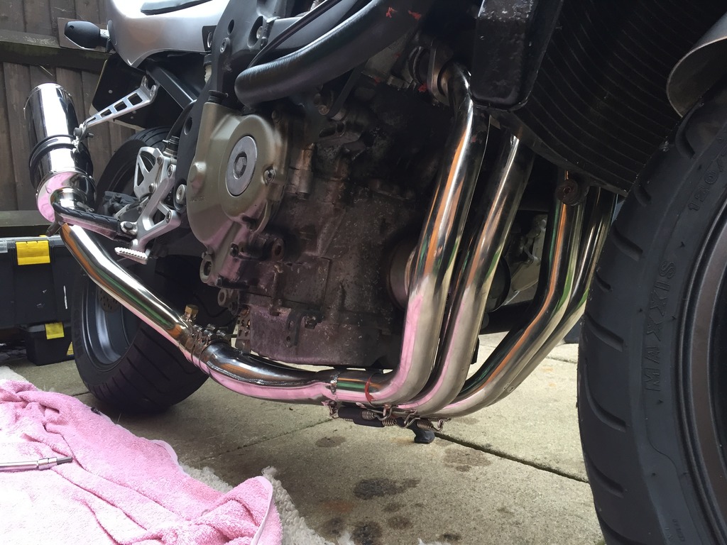

Ah yes, been meaning to update. Thankfully my brother in law came to rescue and persisted with drilling them out, several hours and £150 later he done it
He also fitted my down pipes too!
