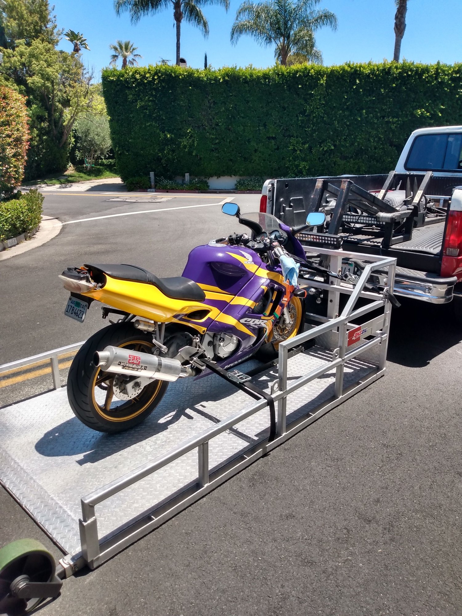

Then on a day I rode over 90-miles many of which were 100mph+ (no problem &#128521, the bike shut down 20-miles away and I had to have it towed back home; same exact symptoms. I did some tests and sure enough the relay was not supplying power to the pump, so I ordered a new one (relay), put it on and the bike fired right up - pump' a pumping - 100 mph+ no problem. Rode the bike all weekend to the beach and the store, then rode it to work last Tuesday (Monday was Memorial Day). Rode a total of just over 80-miles and the bike shut down again, same exact symptoms. 🤨 Had it towed back to the house (the tow truck driver laughed &#129325, ordered a new, more expensive relay from a different manufacturer and put it on. The bike fired right up, rode all weekend 100mph, blah blah blah...
That brings us to yesterday (June 6th, 2022). I rode the bike to work and kept it below 75mph like a girl (no offense girls) and as soon as I got a few blocks from work the bike shut down and I had to have it towed back to the house again (3rd time in like 12-days @ $100/tow &#129324. I took the tank off and changed the petcock out with a brand new one I had ordered and then tested the relay: 12.2v in, zero volts out. When I inspected the relay more closely I noticed the housing was bubbled up on the top. When I checked the previous one I changed out the week before I noticed it was bubbled up in almost the same place and the housing was cracked. So, I'm asking you, what is going on? What is causing my brand new cutoff relays to go through a complete meltdown? The bike is made for extreme (track-worthy) riding, but am I pushing it too hard?

Yeah, me too. Three melted down relays in less than 90-days, three $100 tows in just over two weeks and fired from my job, but the fuse never blows, and I put a new relay on and the bike fires right up until the new relay melts down once again. Never heard of such a thing.
