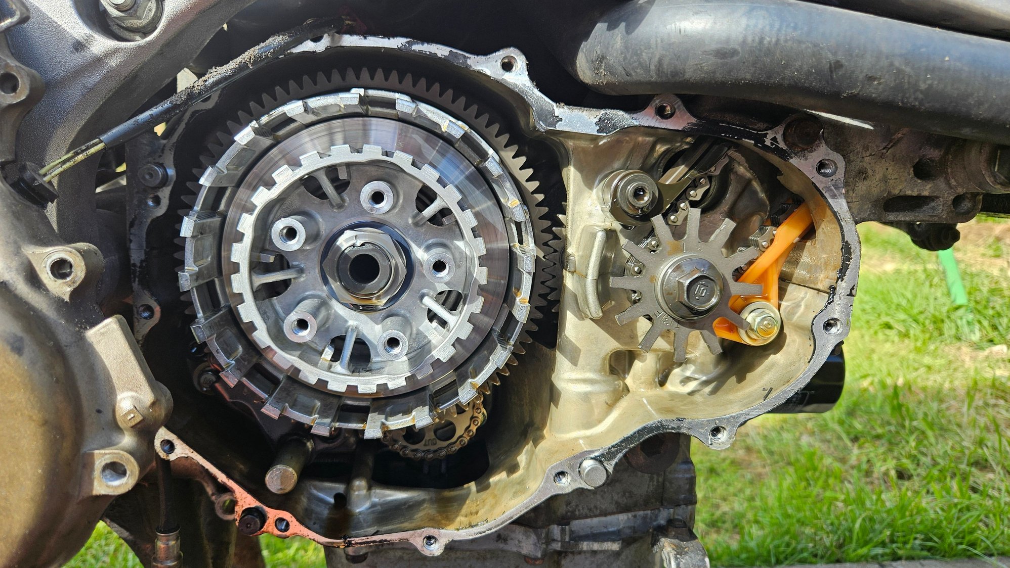

Hi,
First of all, I'm sorry if I'm not posting this in the correct area, im new to this forum and have no idea on the setup. Looking for some help... I have a 2006 CBR 600 F (UK model) I have just taken my clutch friction/steel plates out to replace with new ones.. I have watched numerous videos and instructions and I see in these videos that there are judder springs. Upon removal of my own friction plates and discs, there are no judder springs in my bikes clutch? Should they be here or not on this model?
I dont want to put the new friction discs and plates in, if there should be a judder spring seat etc.
Im hoping someone will know the answer to this.
Thanks.

Welcome to the forum, take a look here:
https://www.motorcyclespareparts.eu/...les/e-6-clutch
I can not see any judder springs, just the main spring.
One of the guys that have replace the clutch of the 2006 model (F4i) should be along shortly to confirm.
Thank you for this! This diagram is exactly what I was looking for.
Every one I found had shown judder springs, but obviously I was looking at the wrong ones. I couldn't find it for my model.
