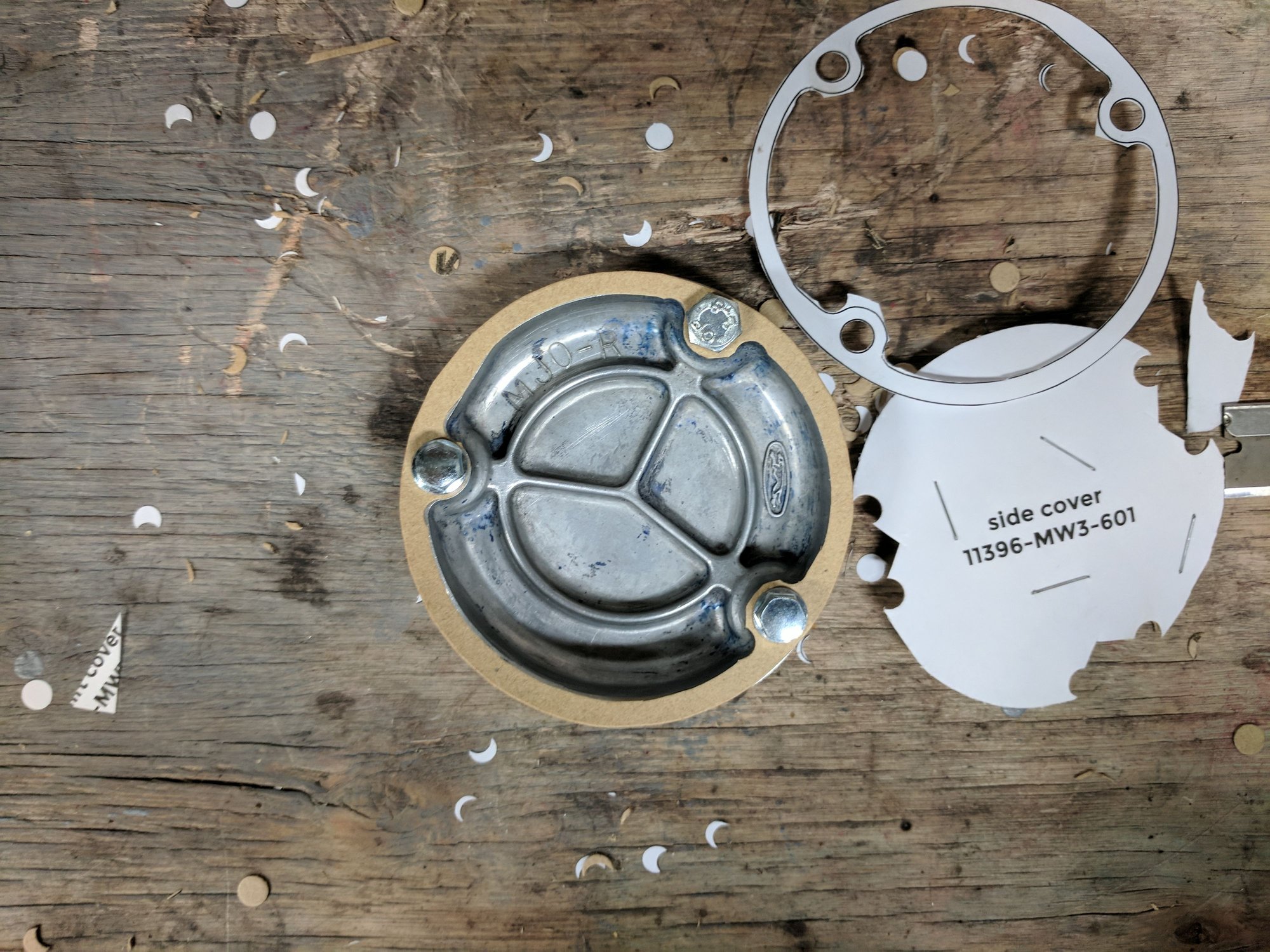

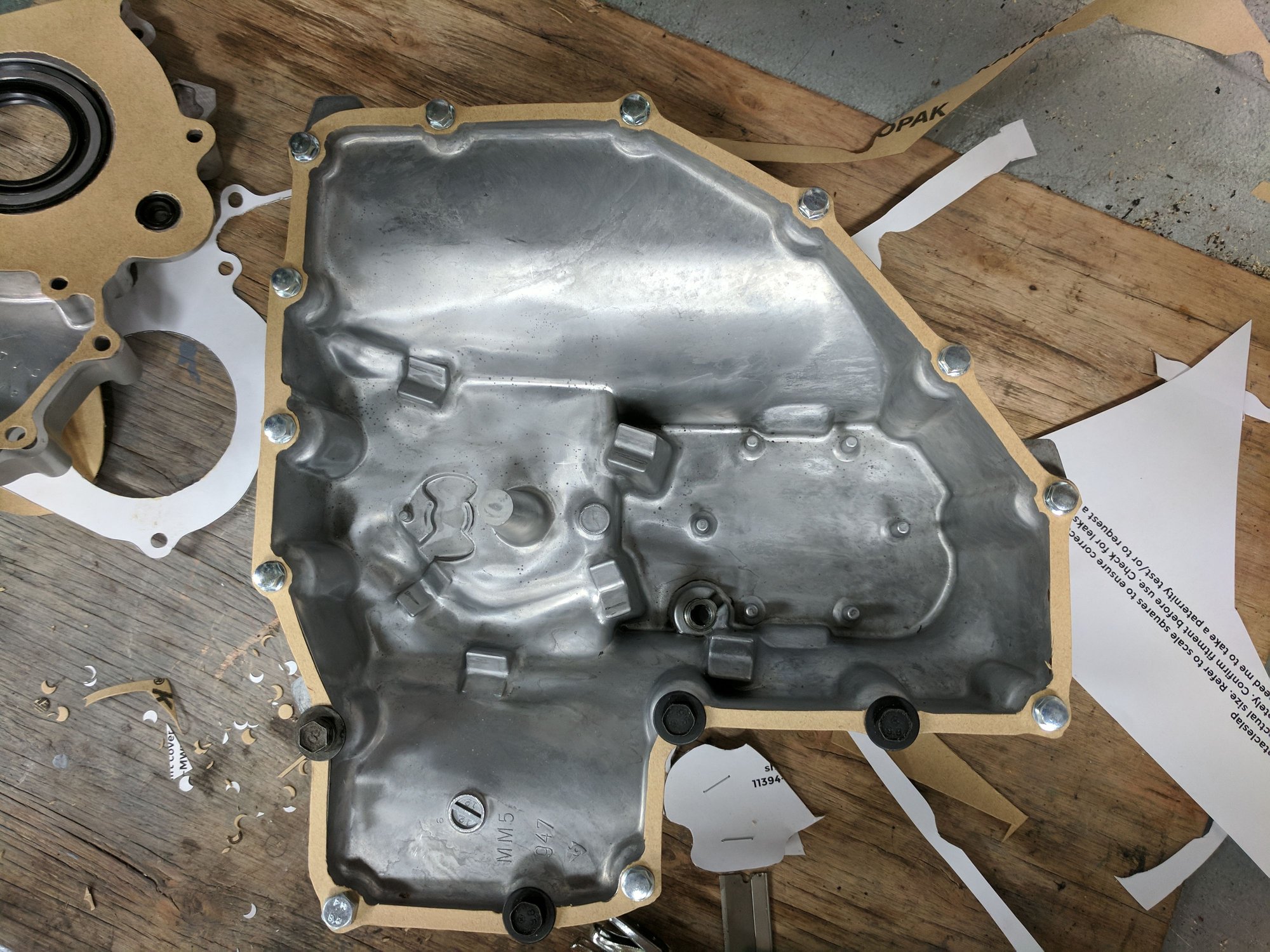

Made a minor update to correct alignment pin holes on the shifter cover gasket that were tighter than they should have been, and also to flip the shifter cover gasket to make it possible to mirror-match the part more easily. The existing link will lead to the updated version. Here's pics of each one test-fit
