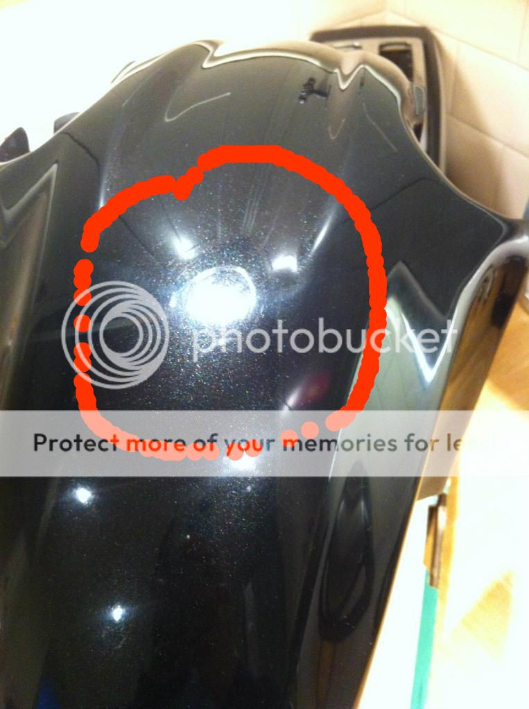

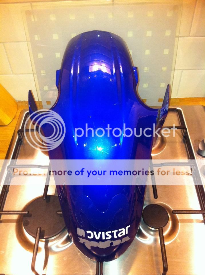

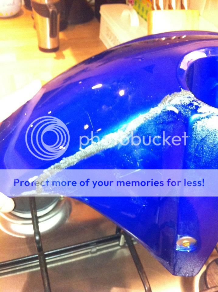

Hi iv just recently painted my front fender by rattle canning it.
All went well apart from the last part,
I have been rubbing with some compound with my orbital sander with a compound pad on that was ok it really brought out the colour there was a few places i could not get with it so i did the, by hand but by doing this i have put swirl marks in it.
Is there a way to eliminate this here is some pics of before and after.
I took pics all the way through so might do a full write up soon.
Its hard to see the marks but where the light is thats were they are.

Get finer grade compound and continue rubbing. To get swirl marks out the compound should be like the finest grade you can get. And I wouldn't use the machine on that so you wont rub the paint through. I sometimes deliver stuff to a painting shop that paint high gloss high end furniture, and they have this super-duper fine compound that takes off the finest markings there is, like the kind you don't even see anymore, but what creates oil-like colourings when looked from a certain angle.
Cheers mattson got some today it was called finishing compound after a little patience it came out looking sweet.
It will never be as good as a pro but am really happy the way it's turned out.
