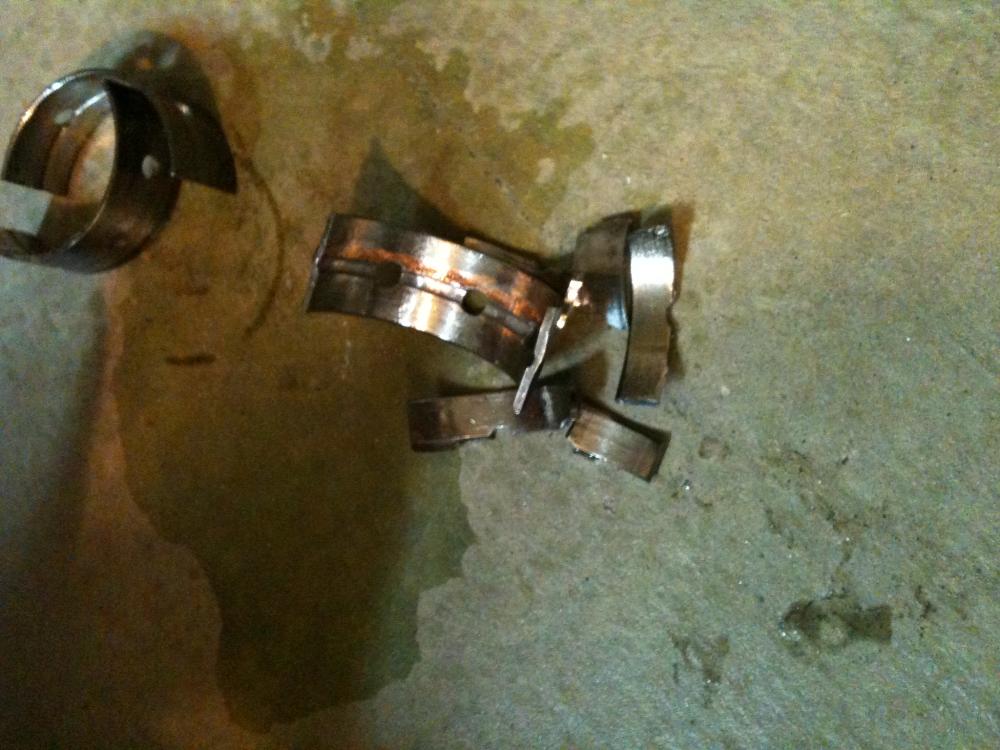

yeah- Like these!!! For Gods sake man, it cost you enough- You might as well share some more ics for us all to check out!!
Exciter, who will likely be making a couple coffee tables himself.
Oh, and trust me- this is EXACTLY how they came out. no ****! Still cant believe how well it ran…...
Attached Thumbnails shop says new engine, i say no. hi-def pics fyi-photo-2.jpg

^^ Yep, that's a fine set of bearings. lol..
I like when one half is paper thin and razor sharp like that..... or when one half slides under the other half. That's a good burn.
Which reminds me... OP, make sure you look under the caps real good before sticking your hand in there. You don't want bloody oil everywhere.
