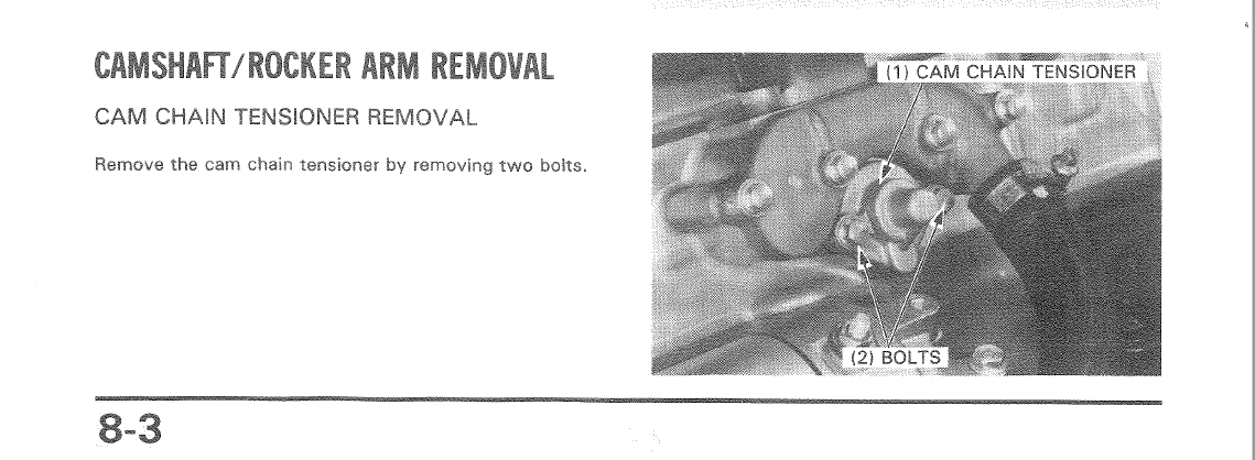

Hi do you mean the Cam Chain Tensioner or the Transmission drive chain

the chain tensioner the bike runs awesome but it makes that noise driving me crazy if you rev it up a little it gets better the noise goes away

Hi , have you taken out the CCT to check it?

Hi, I live in the UK, but I have got a manual I can send you, it's only 2 bolts to take out, all you have to check is that it moves in and out easily, and take down your e-mail address that could cause you problems, if need be PM me

no mine's different it's full bolts it's inside the motor it's a 1988 hurricane CBR

Hi, this is what your looking for CCT
