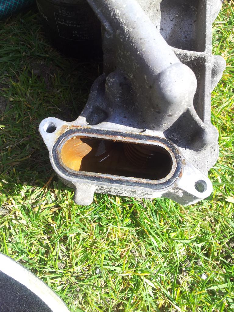

The oil cooler, seals looked all good Demon, I too have kids and another in the oven (just found that out the other week) so things tend to take awhile to get done on the bike, ie if I don't need to spend on it then I'll make do for now....for now. I'm getting the water pump seals done so hopefully that'll fix it. If not the the oil coolers next.
The gunk in the cooler, all cleaned out now and back on the bike

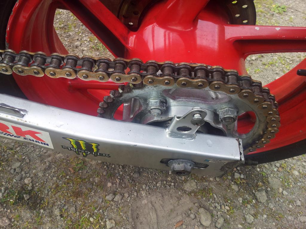

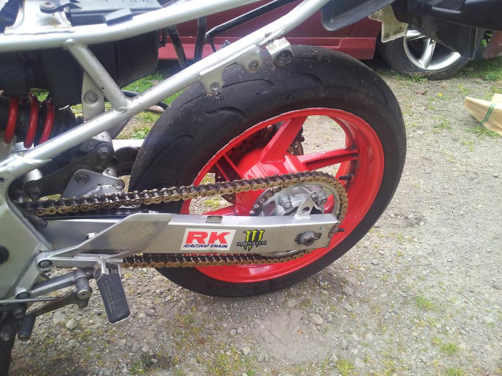

Out with the wife's tooth brush and gave that chain it's long due clean and re oil, all pretty now

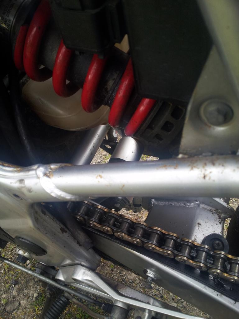

All the rear shock linkage and lower frame now cleaned up, could do with a paint but I think the odd chips off the paint make it look battle hard... Old salt you could say

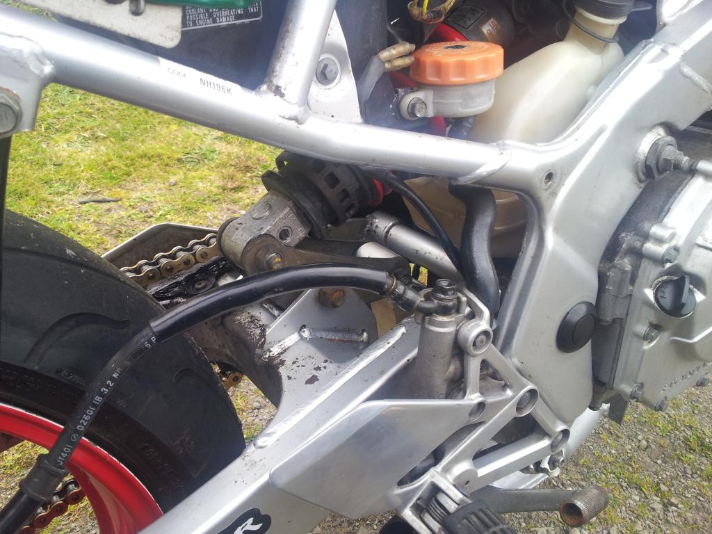

Also took the reservoir out and got that gunk out cleaned it off the side of the bike
Also hit the rear sprocket with the degreaser. Come up nice

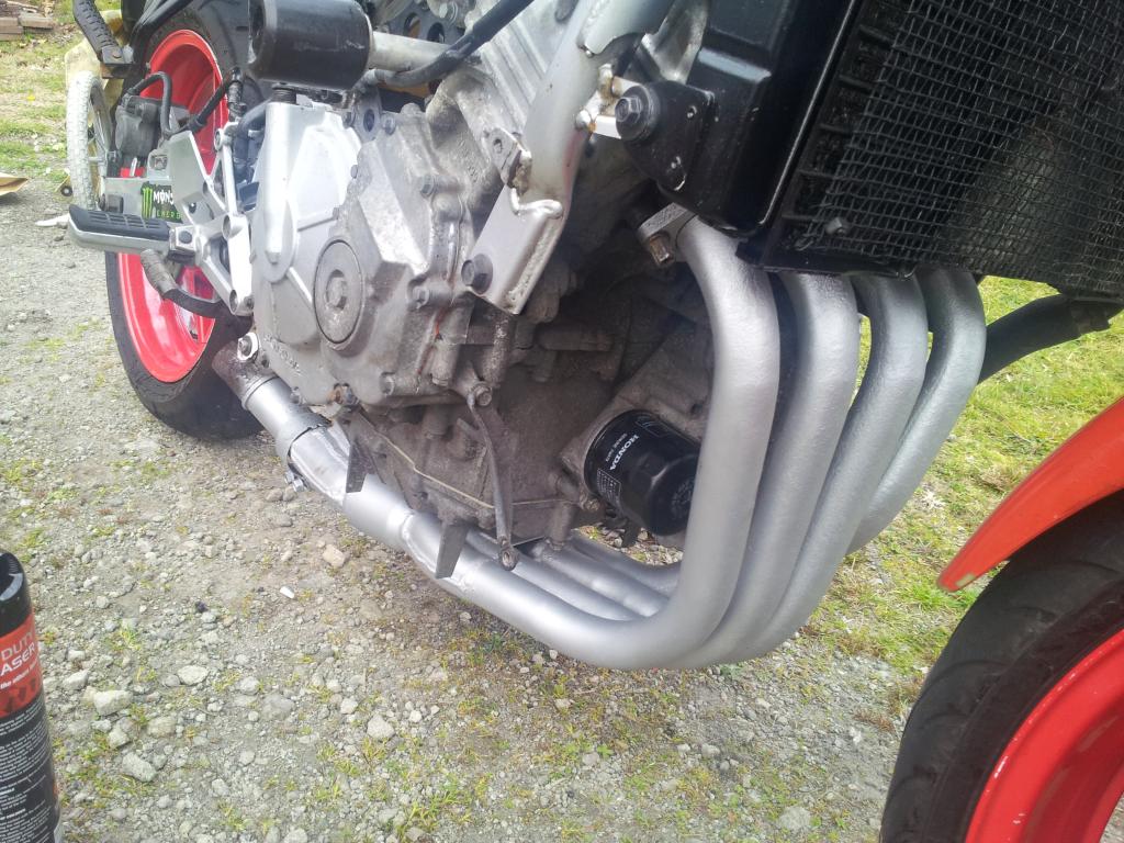

Hit the headers with sum 1400degree exhaust paint, better the the old rusty brown they once were. New oil filter and plugs installed while all was easy to access

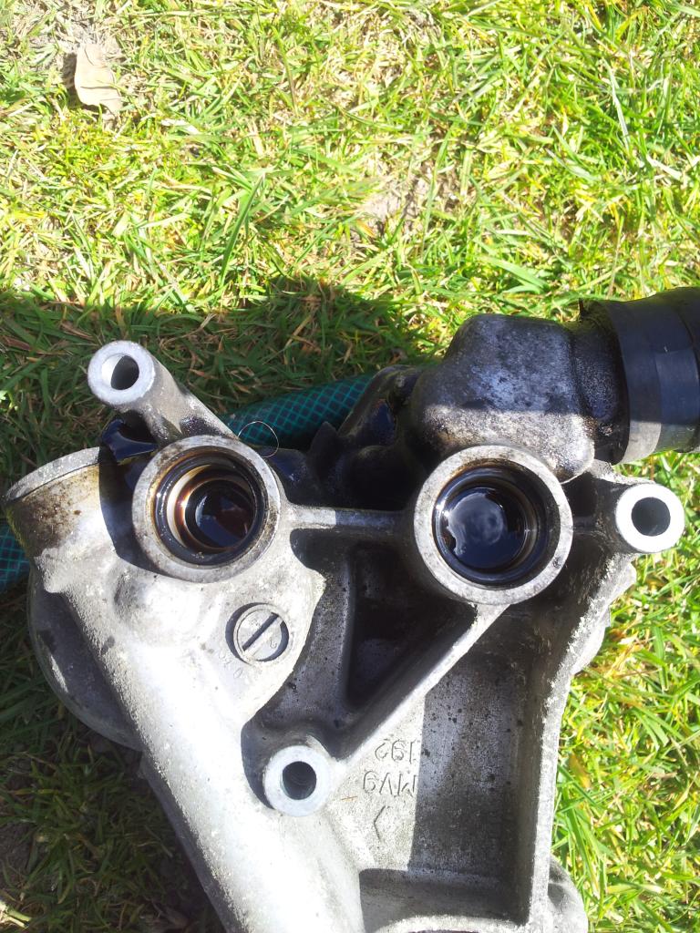

Had a phone call from the bike shop today. They can't find any one doing seal kits in NZ or pumps either. However they say they can get one for around $340.00 and it will take 3 weeks... f!#k that.
I've spent the last half hour scanning the net and I can see 1 assembly and 1 casing on ebay. Both from the same guy, he's just broken it down and selling it in pieces.
Then found a supplier in NZ who could do $220.00 plus freight and again 3 weeks. Have just found a supplier in NZ who has both the whole unit and gaskets and seals etc.
question,
Is it better to buy the whole she-bang or if not what bits.
Can some one with more know than me have a look at this site for me and see if the parts are indeed what I need. Seems a whole lot cheap to rebuild.

Take some pics of it disassembled and throw them up. If the blades on pump are turning fine, clean it up with some paint thinner, order #5 and #15 and go with it!\
EDIT:
There's a chain that runs off the primary shaft that spins the oil pump. That rod on the end of the water pump hooks into the oil pump and that's how the water pump spins. That is just a shaft that churns the blades. So, unless that shaft is severely out of round, I don't see how oil is getting into the pump itself. Usually, oil leaks from the case because of a bad #15, and water leaks out of the pump because of a bad #5. If something is wrong otherwise, it looks like you'll have to buy the whole assembly.
EDIT:
