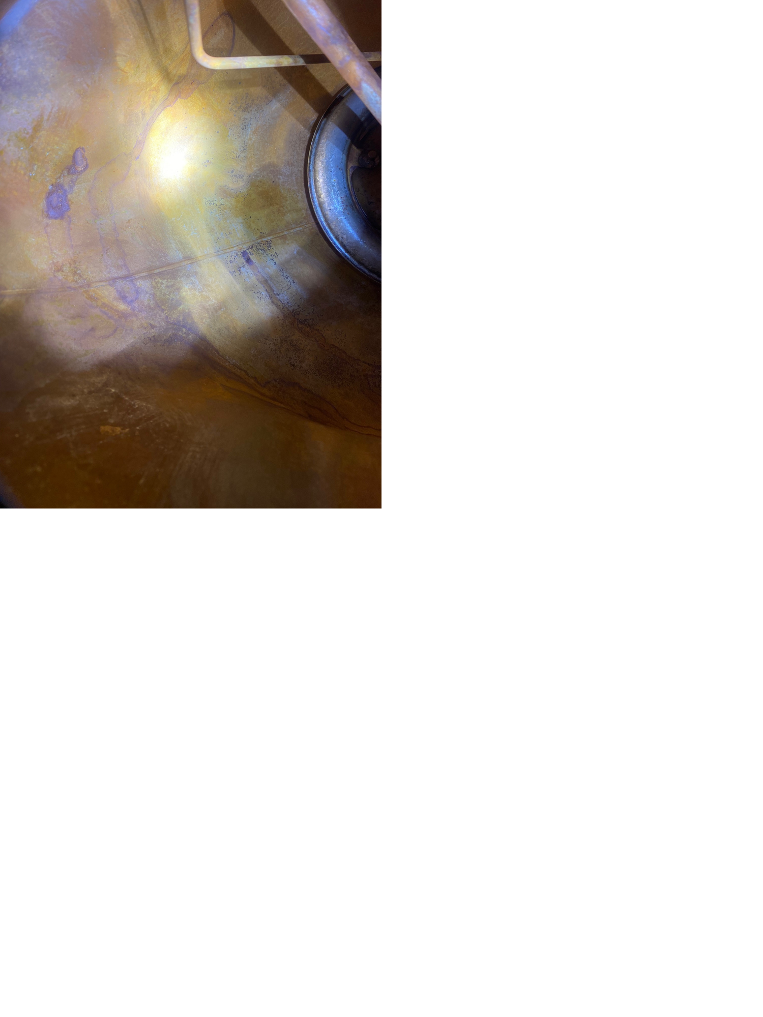

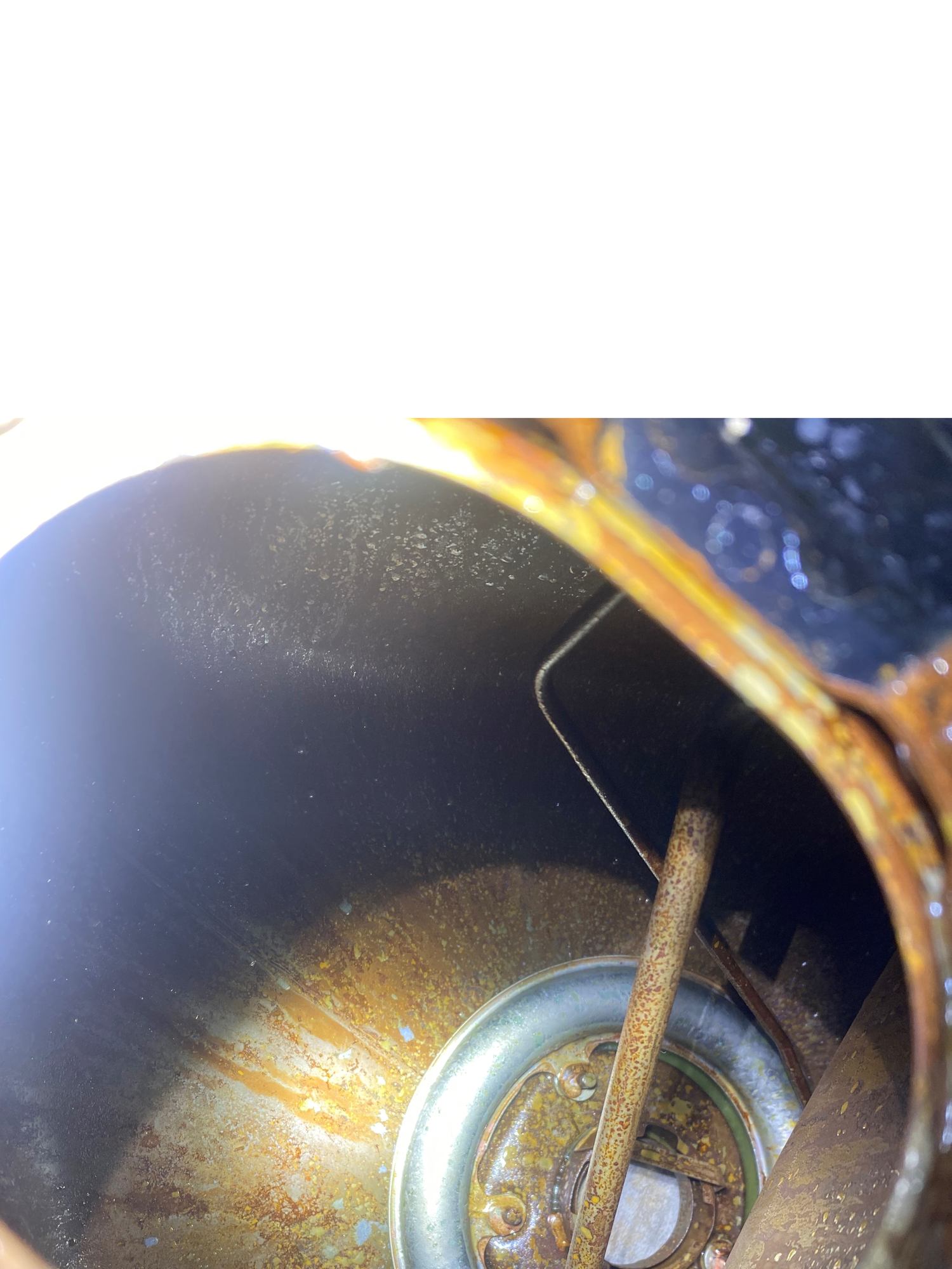

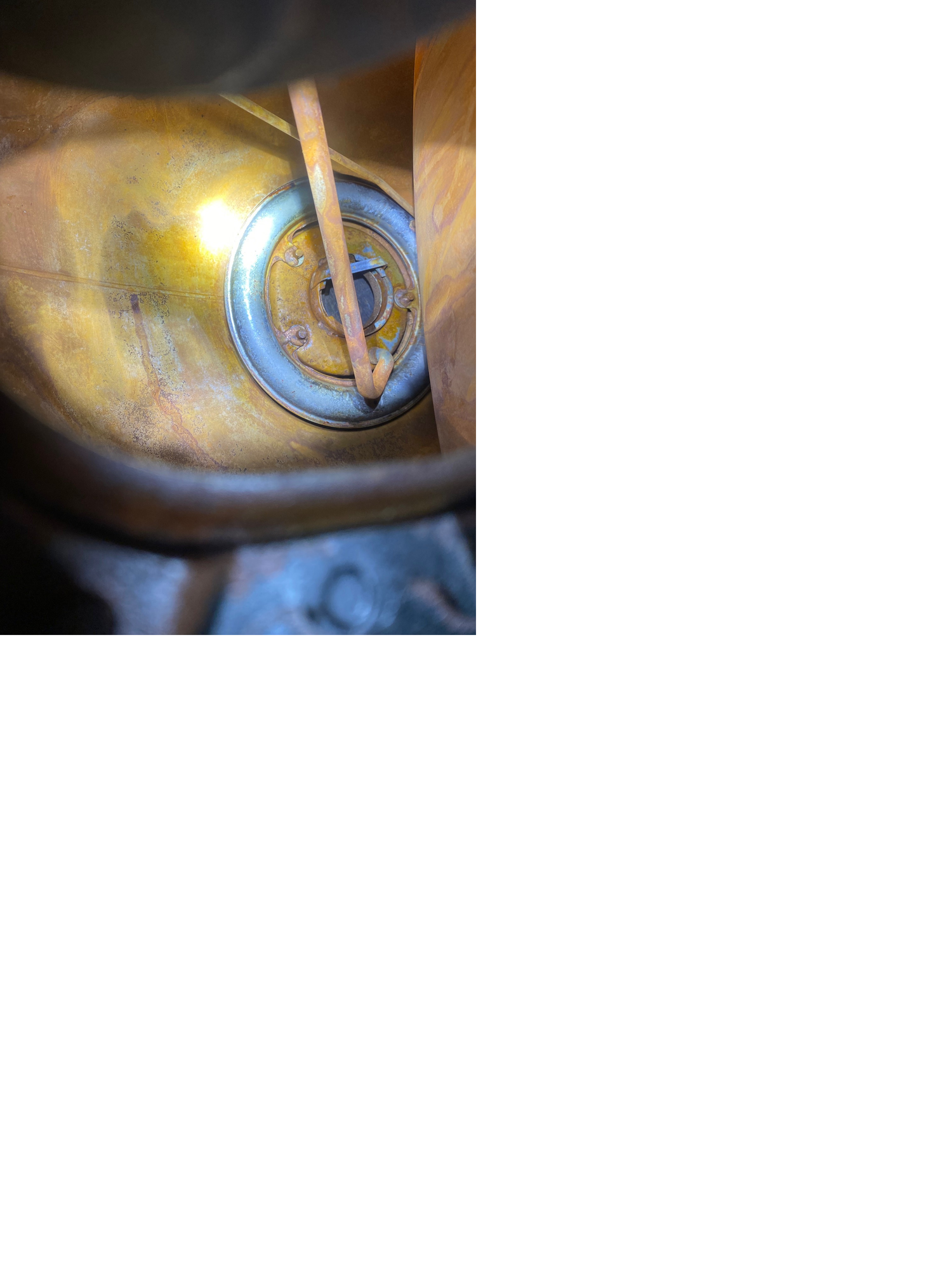

My CBR fuel tank is rusted inside and I need to clean it before it gums up the fuel system. I've gotten all the heavy pieces out and cleaned out all debris possible. I put some white vinegar in the tank along with some other fuel cleaning elements. I left the nuts and bolts in the fuel tank and put it in the back of my truck for a week in hopes of the nuts sliding around in the tank and cleaning the inside. This helped a little but still rusty. Since then, I've tried putting muriatic acid inside. This does a very good job of cleaning the inside of the tank of all rust however if I leave it in the garage overnight, the next morning the entire tank will be rusty again. I've also tried putting WD40 in after the acid, rust still comes back. I've tried putting acetone and also water, rust still comes back. The rust that comes back is nowhere near as bad as it was to begin with, but I can wipe the rust out with just a finger or a towel. Obviously I cant reach the entire surface of the inside of the tank by hand so I am lost. I feel like I've tried all the "how to remove rust from tank" videos on Youtube and the rust still comes back.
What am I missing? What chemical will prevent the rust from coming back? Or do I need to flush it with muriatic acid once more and then fill it completely with fuel to stop the rust from coming back... I have attached a few picture of the inside of the tank. The pictures titled Tank3 and Tank4 are after sitting in the garage overnight.
Thank you in advance

You need to completely rinse out tank to remove all traces of acid when done. It will actually cause rust. Also make sure ALL rust is completely gone at end. Electrolysis is best method for removing rust as it only attacks rust and leaves good metal alone.
Need multi-step treatment after you're down to bare metal. Some sort of rust-inhibitive layer along with protective coating. Check out POR-15's kit.

To rust, it needs oxygen and water - you need to eliminate one or both. Your problem is you're cleaning it down to bare metal and then leaving it damp. Iron is one of the most reactive things on the planet - ever used a metal fire starter? The sparks are just bare iron with the rust chipped off being exposed to the air - The iron in your steel tank is no different.
So either put some gas in and shake it around then seal it, or spray it with an anticorrosion film, like CRC marine corrosion inhibitor. You want to get it good and dry first though - blast it with a hairdryer for half an hour or something. Don't let ANY water or water based products near it once it's clean - it will flash rust immediately.

You just need a jug of evaporust - You're using the most toxic thing you could possibly try. Stop with the acid - you're going to destroy it. At this stage you could just use vinegar, then rinse it out with isopropyl alcohol, then put some gas or diesel in and swish it about to coat it, then seal the tank with a plastic bag or something.
Normal gas tanks have no lining - they just don't have any water in them either.

White vinegar is chemically created acetic acid - it's great for gently cleaning rust. Just remember the key is to get the tank dry once you've got the rust out and then protect it from any moisture.

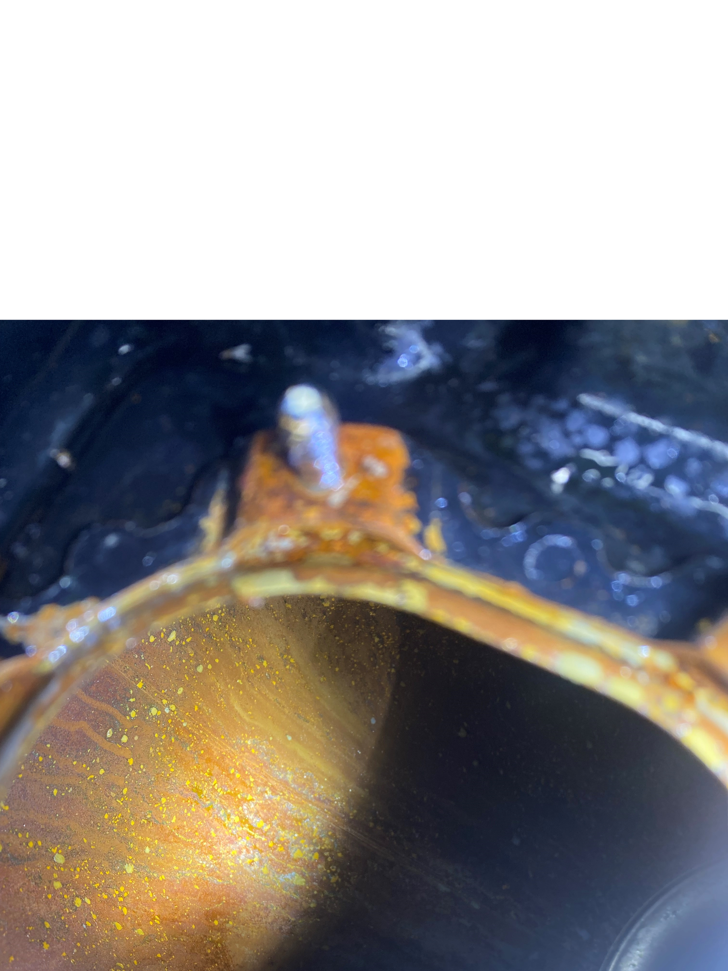

Okay, so I rinsed the tank out with white vinegar and then got it as dry as I could with a heat gun on low and compressed air. The tank was pretty dry inside and what little was left at the bottom, I wiped with a paper towel. I then left the tank on its side with a fan blowing into it overnight in the garage. The inside of the tank now looks like this... Almost all of the heavy deposits are gone so now I am just worried about the thin layer of rust that will effectively mix with gasoline as it goes through the fuel pump. I guess I will have to try that POR15 kit for the motorcycle fuel tanks. Unless you guys think this isn't bad to just run through the new filters I have to install. Thanks
