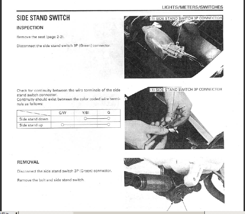

hi!it happens to me once!it was the wire connector under the sit!is that when you take up the bike stand ,switch off the yellow lamp at the cluster (s)

Sidestand switch for sure
