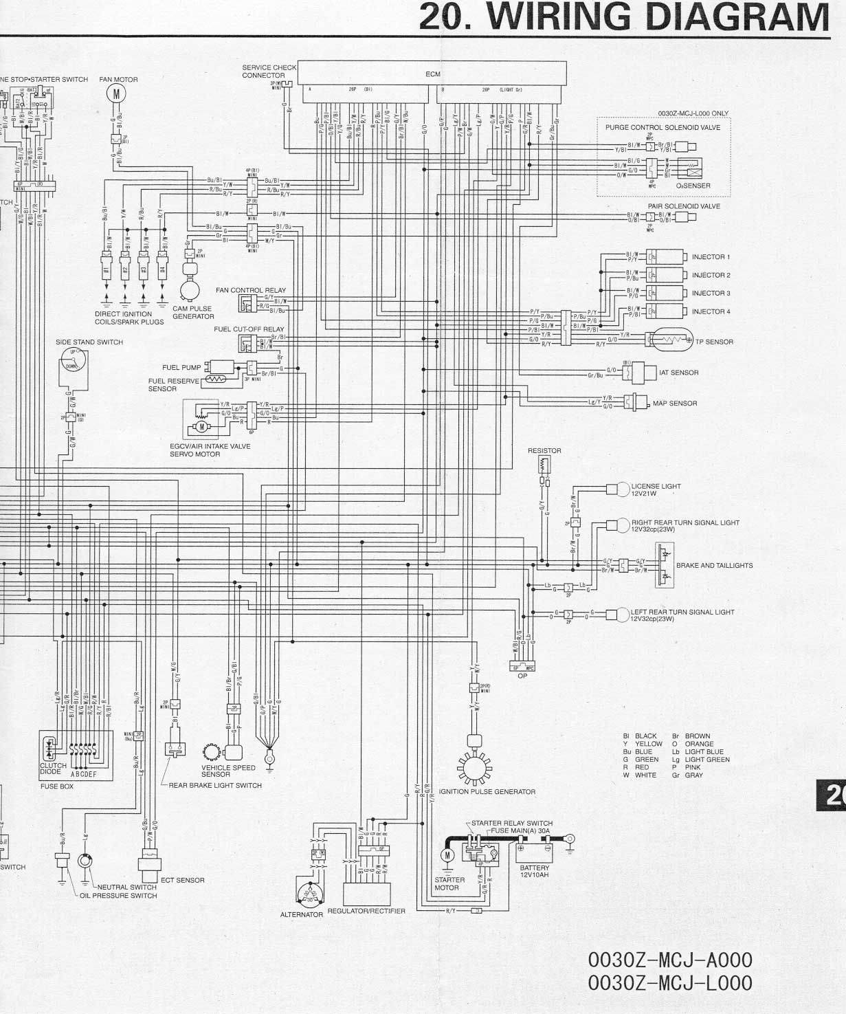

Honda 954rr I was trying to troubleshoot an issue and noticed a 4 wire connector coming off the right side brake side of the ignition coil sub harness not connected can someone tell me what that connector operates.. I have circled the connector

(6) is the injector harness, not the coil harness - that's (7)
Looking at the wiring diagram I would suggest it goes to the TPS?

Default O crap I took a screenshot of the wrong one
Well crap I took a screenshot of the wrong harness

Thank you for the correction I had updated my photo

that's the connector from the coil harness to the main loom? If that's not plugged in, none of the coils will fire.

Well that's the wrong plug as well I finallfound the right picture

I have no idea how many wires going to that connector or what shape it is from that picture - maybe you can work it out from the service manual...

Thanx I found that too but couldn't tell where it was lol... I purchased this bike not that long ago to issue I was having under a hard load second third gear it sound like it was jumping or cutting out around 8500 RPMs after a week on and off of searching I found this plug disconnected so that's why I was curious what it went to or would it did because I plugged it in finally took it for a ride last night and everything seems to be fixed...

If you'd noticed the color of the wires, or how many - you'd know - I guess it was for the PAIR valve, as everything else is kind of important.

Thank you I will look more into it i believe there was a gray green black and gray
