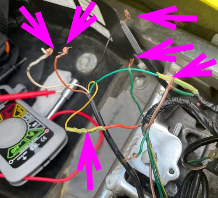

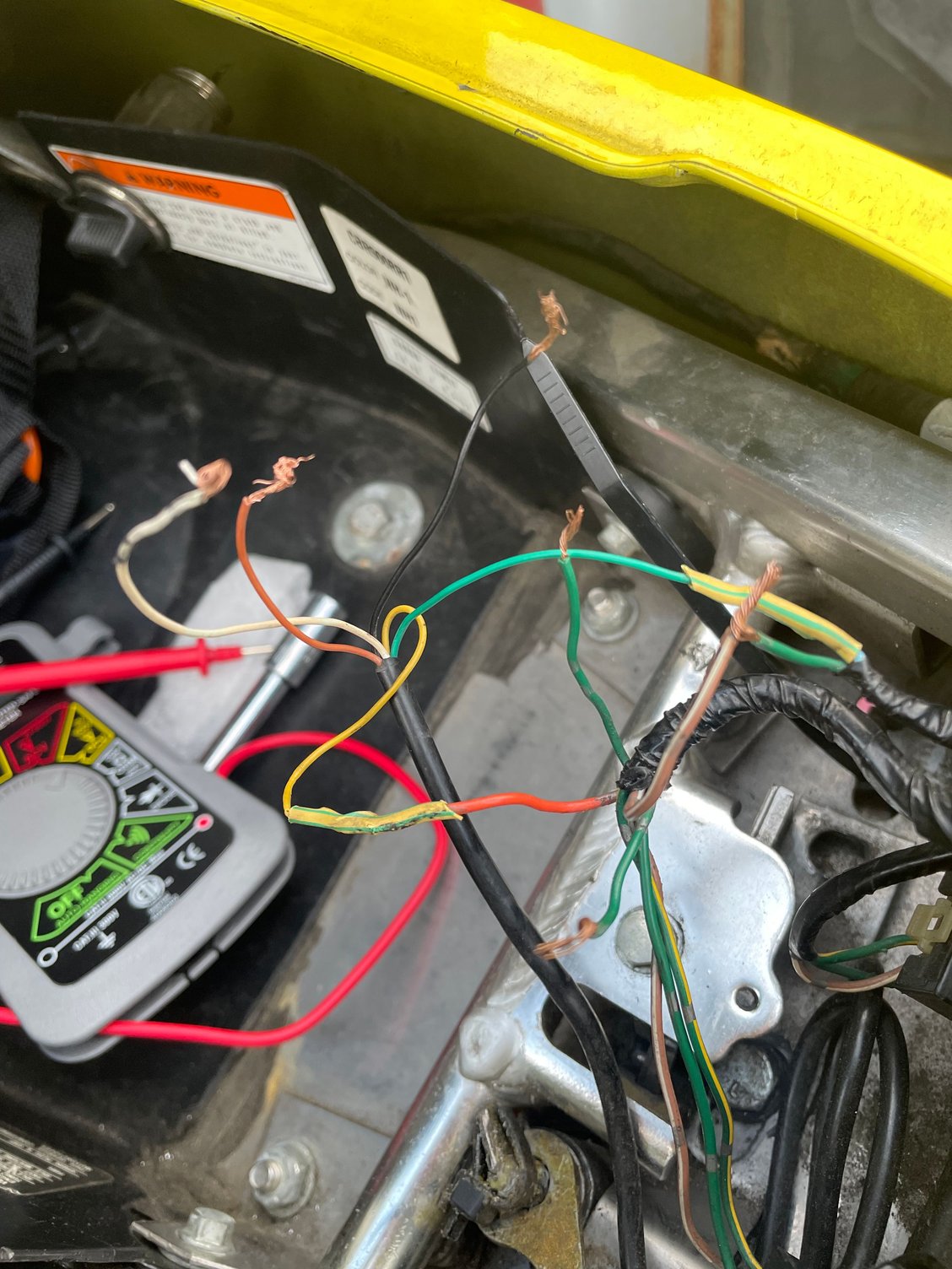

Hello everyone I’m in desperate need of help with my 2001 CBR 929RR. My running tail light doesn’t work, but the front brake light does work just not the rear. But my main issue is the wiring that’s totally chopped up from the previous owner and I cannot find a single person yet who can help or understands what’s going on. I don’t know what wires go to where. I’m new to bikes but not to cars, I’m a mechanic but literally have no clue what’s happening. If someone could help me out that would be amazing. I’ll attach and image so you guys understand the Tom Foolery happening with these wires. Thanks to anyone who can help!!

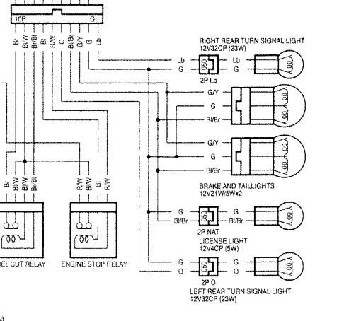

If similar to the F4I then:
Light Blue and Green are L/H turn signal
Green / Yellow, Green and Black / Brown x2 are for Brake and Tail Lights
Green and Black / Brown are for the License Light
Green and Orange are for the R/H Turn signal
It does look pretty close as far as I can tell from the picture.

Greetings and Salutations!! Relax… take deep breath…. You can do this… It looks overwhelming with all those wires! Just need to stop trying to "forge ahead" and "get things done" and take some steps back... Instead, you'll want to fix harness and restore back to factory OEM configuration with original connectors. Fix this one wire at time… Before you know it, ALL wires are done and back to OEM configuration and your bike will work like brand-new off showroom floor! This is literally 5-minute repair!

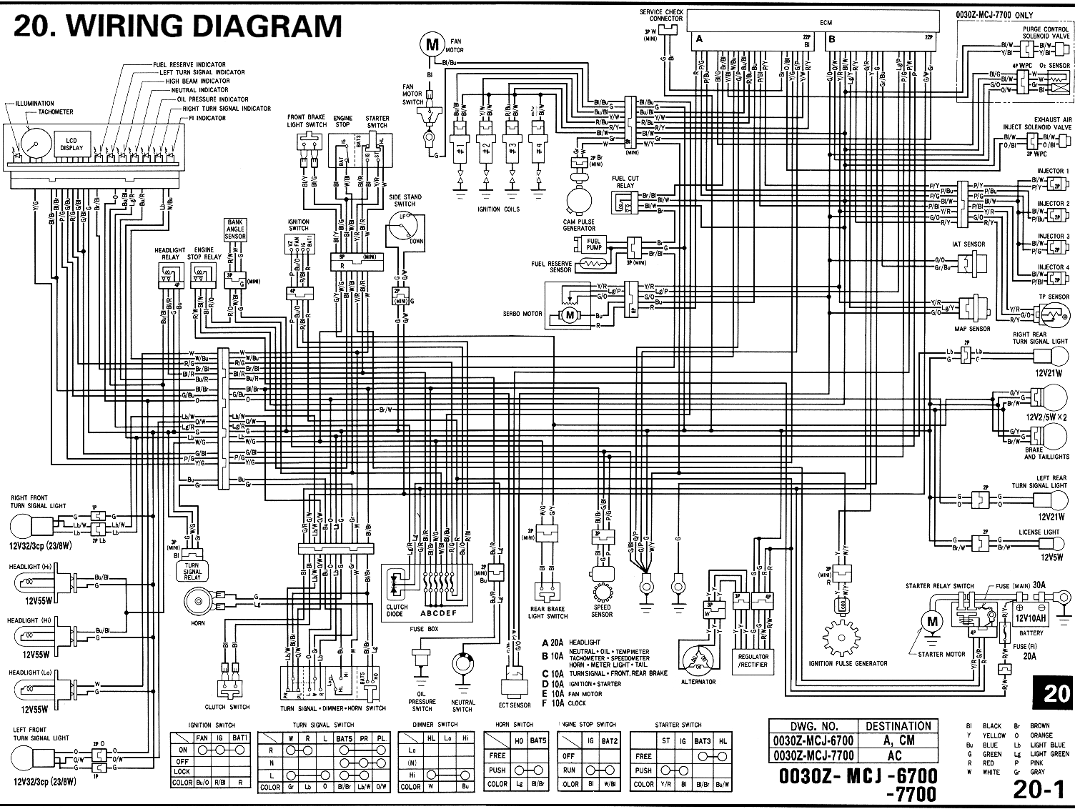

Here’s wiring diagram for your bike. Although you really only need taillight section posted above.

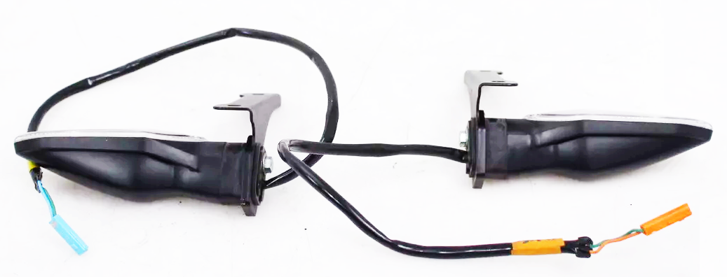

2x 2-wire connectors for harness (turn signals): https://www.corsa-technic.com/item.p...ategory_id=278
2x 2-wire connectors for turn-signals: https://www.corsa-technic.com/item.php?item_id=415

2. Add factory OEM connectors to integrated taillight. One 3-wire connector for brake/taillight and 2x 2-wire connectors for turn-signals.

While you’re waiting for connectors to come in, you can map taillight wires.
1. Disconnect light from harness. Remove 2x connected wires; we’re going to add connectors to them all.

Next, repair & restore harness with factory OEM connectors. Crimp male terminals onto these harness wires and shove into female connector housings.
left turn signal 2-wire connector = grn + org
right turn signal 2-wire connector = grn + lt.blu
tail/brake light 3-wire connector = grn + brn/wht + grn/yel
That’s it! Harness has been repaired back to factory OEM condition and bike’s halfway restored to brand-new condition like when it left showroom floor!
hmmm, looks like your wiring for license-plate light got snipped too… No reason whatsoever to hack up harness like this. No benefits of any kind. Only causes headaches and endless blowing of fuses! PO should get sound spanking!!
