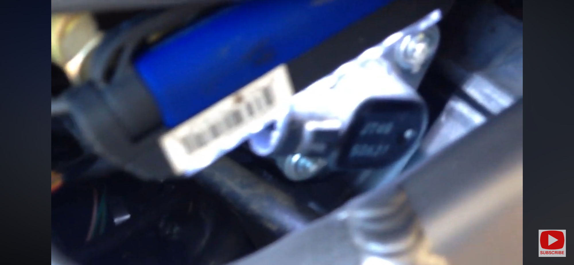

I just changed the gasket on the cct and now my bike won’t start I plugged evething back in properly, I did it with out removing the air box.
ran fine today before I started now won’t fire, fuel pump primes, staters sounds fine. I’m not sure what’s wrong with it now. Pretty devastated.

What did you unplug?
It's almost certainly a bad connection, unplug each of the connectors you've disturbed, spray it with connection cleaner and put it back together making sure it seats fully.

I unplugged this connection right above the cct it’s ether the fuel injection sensor or throttle sensor
I unplugged this connection right above the cct it’s ether the fuel injection sensor or throttle sensor that’s the only plug I’ve touched. Made sure it was back together properly. Did have The Fi light come on, only comes on for a second when I turn the kill switch to the start position. Just comes on for a second then goes off.

Pretty sure I just unplugged the throttle sensor. Just above the CCT.

So when I finished doing the gasket put it all back together, went to start it the battery had some how gone flat, gave it a decent charge and yeah just wouldn’t kick over, sounded like it wanted to start gave a couple of putt putts then nothing,
