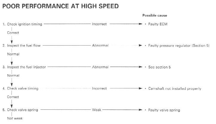

That should rule them out then, onto the next steps of the fault finding as per the extract from the workshop manual below, do you have a copy?
Points 2 & 3 as they are the easier ones to check, faulty ECM as the last resort unless you can get your hands on one from a mate to help rule out.

I will check the FPR and injector nr. 4.
Can there be other problems like sticking piston rings or bad valve seating (in nr. 4 cylinder)?
