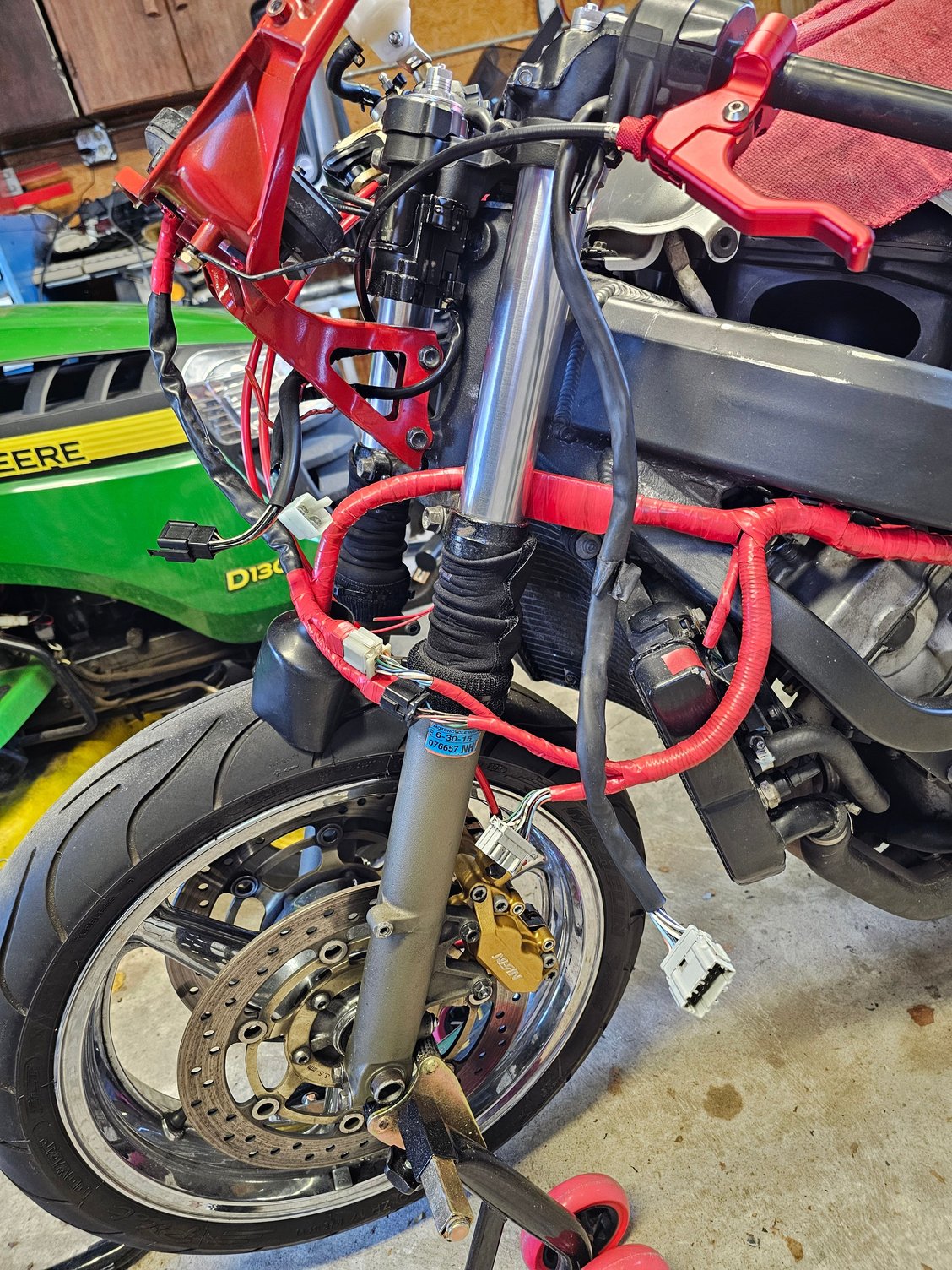

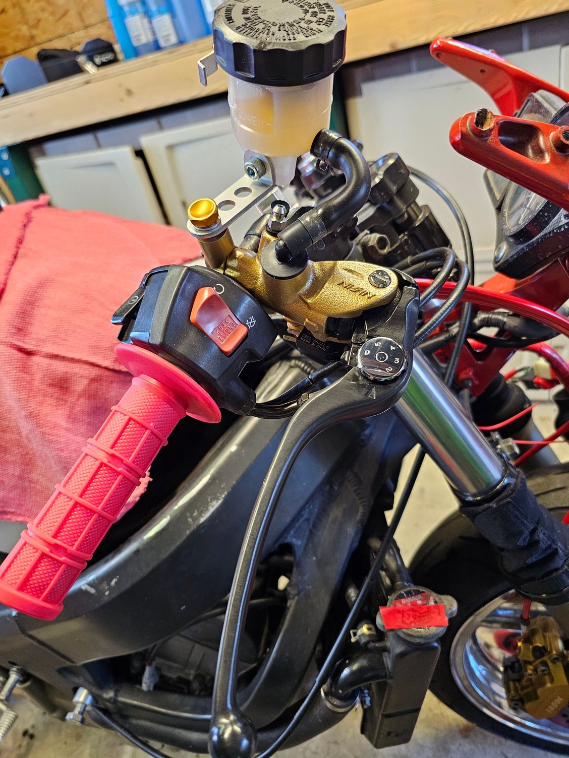

So as title says im building what i think as a semi stunt bike i have the protection and most of the mods that a stunt bike has but keeps the same riding position and farings of the original stock bike. This is a bike that I unfortunately crashed in September nothing major but the entire front end plastic and thin metal was crushed frame and forks are fine.
I have just done my brake swap from a 929 but the rear brake line is slightly too short and dosnt sit flat against the swing arm so I can not use the stock rear brake line clamps im thinking about making a bracket or something similar but also playing with the idea of the brake line being left floating i dont think it will shift and hit the tire at all.
