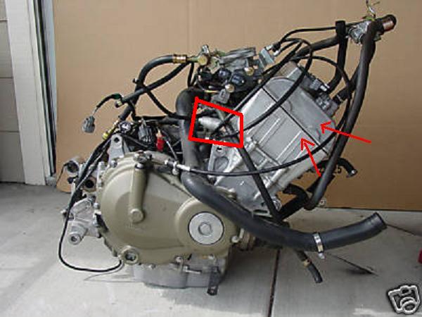

I've added a picture of an engine that shows where it sounds like the noise is coming from.

This sounds like MASSIVE cct failure. Although they usually don't go out that quickly their normally a more progressivly gets worse thing, but there are always exceptions to that. Get that hydraulic cct changed to a manual and see if that takes the noise away. I took the liberty of marking it for you.
My only other thought which I am thinking it isn't, but is hard to diagnose without being there is that a lifter is just about to let go. But I think its your cct which is also WAY cheaper to fix than a valve job!! Shouldn't be more than about 50 to 75 bucks for the cct. If that is still to much skin to spend hit me up with a PM and I'll tell you an even cheaper way but requires a little more mechanical know-how.

You guys rock. That's exactly what the problem was. Well, not exactly, but close enough. Turns out my bike already has a manual cct. And after a quick inspection, I realized that the "bolt?" had some how back itself out almost an inch and half. I tightened it up back to where the lock nut was, and it now runs perfect. THANKS!
