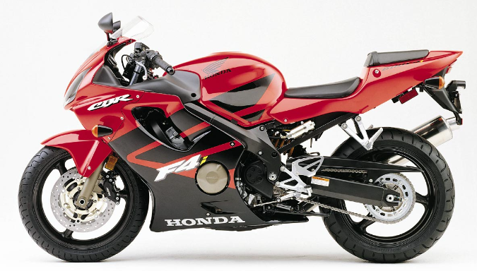

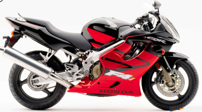

@Nate_Lake Hi and welcome to the forum. Sounds like you've got a great project? What was the condition of the bike when you purchased it? Do you know anything about it's history or have any information from the previous owner? When the CBR600F4i came out in 2001, it had a stepped seat. Honda wanted to make a distinction between the F4i and the CBR600RR which came out in 2003, so the changed the seat and rear sub-frame on the F4i to a single seat, or what some refer to as a banana seat. Many owners of the later 2004-2006 models would make a swap with the rear sub-frame and mount the tail section of the earlier 2001-2003 F4i's so they would have what they thought was a more sportier look. So, tail fairings are not interchangable between them without a subframe swap. It's possible that is the situation you're in. Post up some photos of your bike and maybe we'll be able to tell.
Here is the 2003 CBR600F4i
Here is the 2004 CBR600F4i
