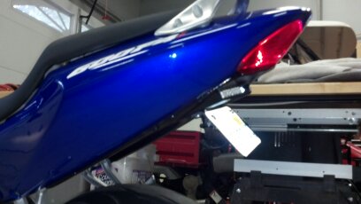

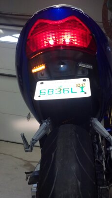

I just went with the unpainted Hotbodies undertail for 129.95 from 58cycle. I spray painted it black. $100 cheaper that way, and if I ever need to touch up or repaint, it is simple!! I am extremely happy with the outcome. Did it myself with the one page directions. Just be extremely careful cutting the rear fender off. Uses the same key lock I already had, which is behind the license plate. (Slips right in)
I am pretty sure it would appease any law enforcement. Bright led blinkers, license plate light etc..
I did take pics when I was installing, and where I made the cuts. Message me if you need the pics.

Just wanted to say Thanks! for the write up. I based mine on that and Im very happy with the results and looks better than if I wouldve spent hundreds of $.
Thinking about going with turn signals on the rear sets. anyways heres some pics:
th_tn.jpg?t=1345834613
you can see in the last pic the little string that i use to open my trunk. I also just ordered some bolt-lights for lic plate.. my old lic plate light is in my trunk and i use it as a trunk light! haha. handy at night. -BTW idk why my pics are so small. any advice to make them normal?
