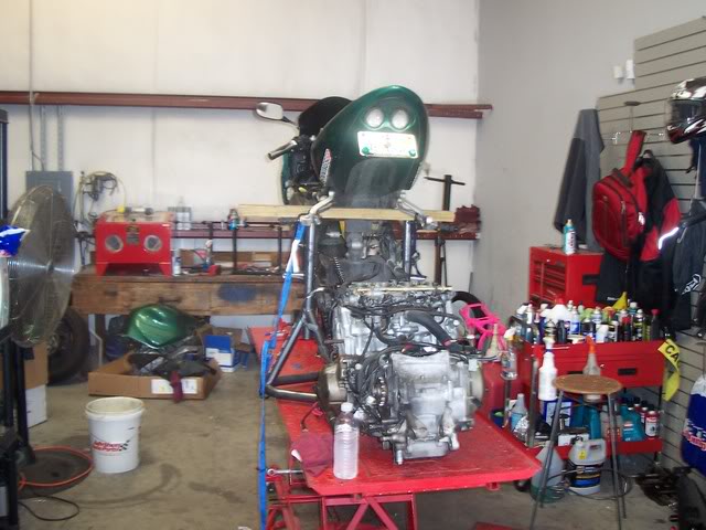

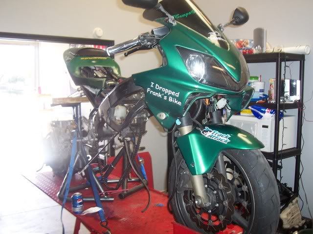

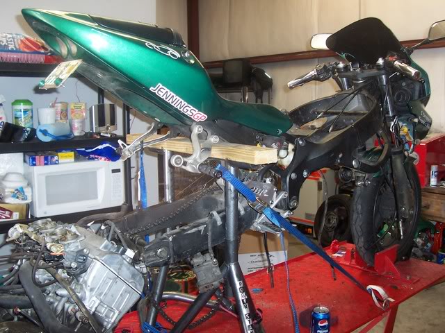

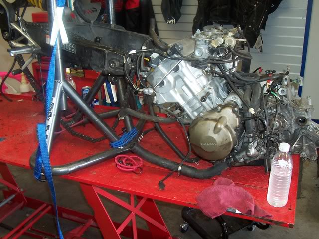

So 4 weeks ago I decide to try to ride.It hurts like hell,but I missed my baby.All the sudden the bike starts slipping out of 2nd gear into a false neutral.
So Without any real experience motor experience and a manual this is what I had to do.
Found the problem .Fugged up shift fork.
Friend of mine sold me an 06 tranny for 50 bux in perfect condition
So I got her put together latweek and she seems to run fine.
You don`t have any motor experience? Sure could`ve fooled me. That`s pretty freakin impressive ~ and atranny no less. With carpal tunnel to boot. You`re a regular John Wayne in my book. Hope you heal well.

1st time I've ever cracked any motor open.Just made sure to follow the book to the exact readings.

good job on swapping the tranny, and having the ***** to do it yourself
the best tool you can have for that job is the honda factory service manual
