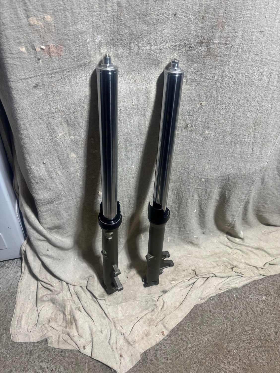

Well, I finally took the plunge and tackled the oil leak on my left fork. I’ve never done any suspension work before, but after some research, it seemed manageable. However, you know how these things go—plus, I had no idea when the bike’s last fork service was, so I was expecting some unexpected challenges.
After two and a half hours of hard work, both forks were fully rebuilt with new bushings, O-rings, clips, some fresh oil, and a thorough cleaning. I must say, I’m thrilled with the outcome, and I’ve gained a new skill along the way.
FYI this thread: https://cbrforum.com/forum/f4i-main-forum-11/fork-seal-leak-rebuild-completed-149264/#&gid=1&pid=4
was an absolute goldmine of information, so thank you to IDoDirt
here’s a photo of the completed articles

Great work - now to get them refitted and set up to your weight and riding style :-)
Must admit I chickened out and had the bike shop refurb my forks (30 year old gloop where there should have been oil and what there was of that was leaking through the seals) and a professional set-up. The difference was amazing.

Cheers fella,
Yeah, I don’t blame you, it’s a messy and awkward job without the right gear! Went through a whole tin of brake clean and half a roll of blue paper.
Just waiting on new snap rings to arrive for the top stanchions so I can get the correct depth.
To be quite honest, the bike’s been in bits more than it’s been whole since I’ve owned it. The last owner didn’t really seem to care about it at all. The forks were in a really poor state, the oil was burnt looking and smelling horrible. Spacers rusty and the right leg had a blown bushing. So I suppose it’s good to have some peace of mind now.
See for the adjustments, I’m not all that clued up on it, how’d you get on with setting your forks up for decent riding?
