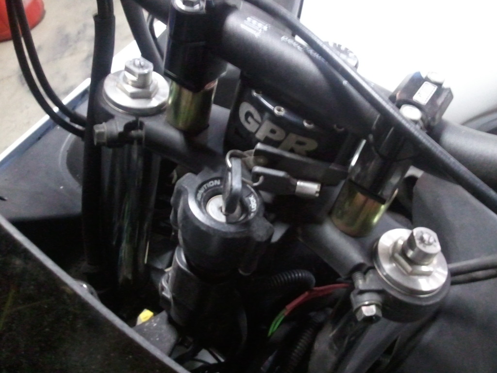

ok so from what i get is after i remove the risers and bars i need to drive the fork tubes up through the tripple trees soo the clip ons can mount oabove the triple trees? cause in this pic it looks like they shoved the forktubes level with the triple trees which is kinda dumb lol

stlcbr600f4_newb Feb 6, 2013 11:00 PM
that is what you need to do... you will want to measure perfect..the data is in the service manual.....any mis-alignment will translate into your ride... steering/ride path/feedback
it will lower the front of the bike ....you might want to check and see if the rear-end has a jack-up kit or washers at the top of the shock...
jack up kit will be a after market and located at the base of the shock assembly connected to the shock/swing arm/and motor mounts...
the way your bike is setup right now will account for your not so comfy corning.... right now your center of gravity is a little out of wack....
man you are going to be amazed when you get that lined out back to OEM
let me know what you come up with...
