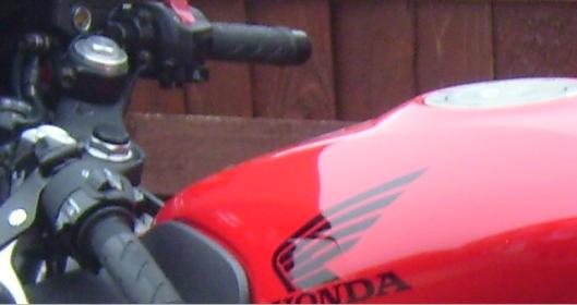

On top of my forks I dont have the sticking up part. (preload (circle with two flats, its just a big nut. No adjuster)
I gotta see this. Can you upload a picture? You have to have preload adjusters. Maybe they are tightened all the way down? I'm not sure if it's even possible to tighten them so far they become flush with the top of the fork tuble.

I seem to recall seeing the 2 of the 2006+ models in a shop in Manchester which had non adjustable Forks....

Well that sucks.. So how come the shock can be adjusted?
Doesn't this defeat the object of adjusting them both simultaneously?
Here is a close up of a pic I have of it. See what you think...
