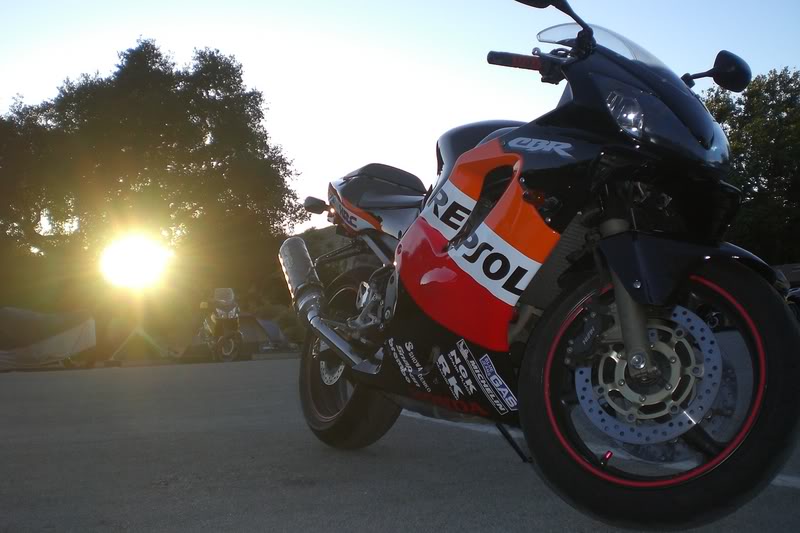

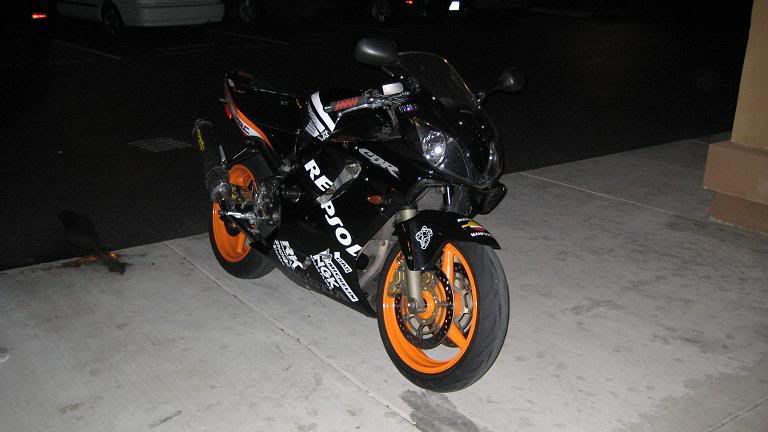

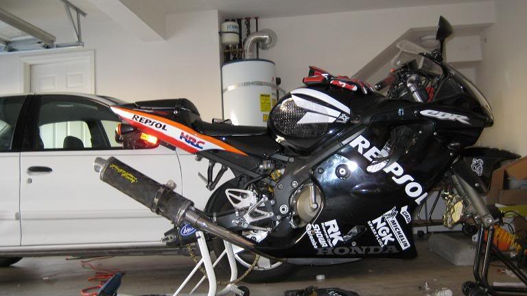

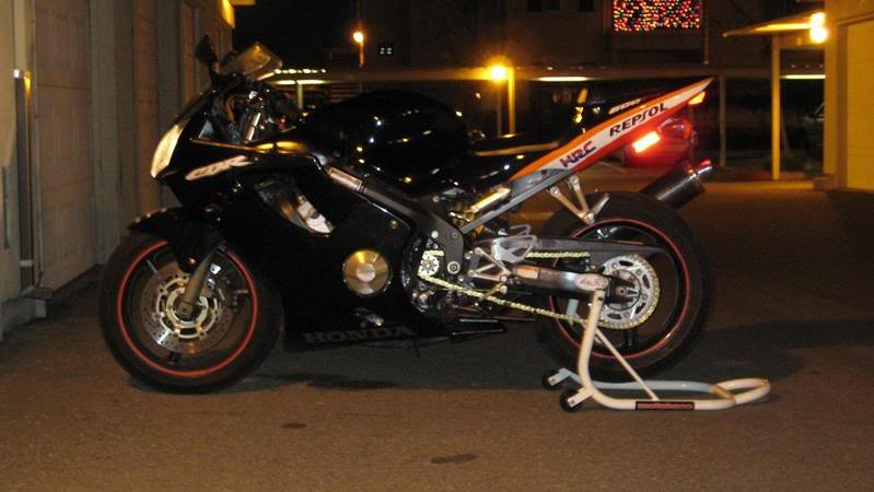

Hey guys 3 weeks later and I finall got my bike up and running again!!!! It started out to be one project and turned into others!!
SO what I have done
Powder coated orange rims
Front & Rear Brake Calipers off the 929!!! ( Did not change MC or upgrade to SS lines)
Polished Front rear sets
Painted Passenger rear sets
Repsol Decal kit
Changed rider pegs to slash cut
Thinks thats about it!!!
For anyone else who wants to powder coat rims it is an easy complicated process!!!
Rotors, tires, seals, bearings, all must come off! GET NEW BEARINGS and SEALS!!!
Have a shop do it if you have benjamins or dont have the right tools!!! If you can punch the bearings out, you a blow torch and heat the inner parts by the bearing. Putting the bearings back and mounting tires should take no longer then several hours.... really... 30 mintues to bearings back in....I paid to have them put in because like i said right tool for the right job! And they are a pain in the ***!
As for the 929 Clipers ! I have noticed a big difference in breaking power!!! Feels more firm then stock! Good decent priced upgrade!!
