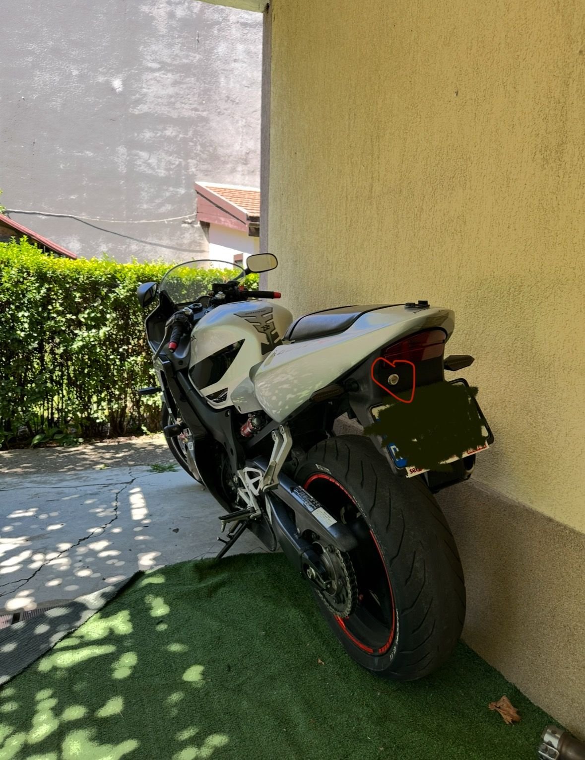

Hey everyone,
Has anyone here done a tail tidy on a 2002 CBR600F4i? I’m talking about the version where the plastic license plate holder has a keyhole to unlock the compartment under the solo seat (like in the photo). I’m looking to either mount a more minimalistic license plate holder or screw the plate directly into the undertail for a more track-like look.
If you have, please drop some pics of how it turned out and let me know how you went about it in the comments.

I made my own undertail for the yellow bike, forever ago and took the key off and put in a 'door lock actuator' that could only be used when the key was in the on position (tapped into a fuse).
I'll hunt the pics down when I get home (I'll try and remember) and post them up.

I'm getting this undertray fitted this week, which has a hole to relocate the seat lock
https://pyramidmoto.co.uk/products/h...NSW59NGyTxQ1-u
I have paired it with this tail tidy, which although is for a different bike, fits perfectly to this undertray due to the 2 flat mounting points
https://www.aliexpress.com/item/1005...6c21180266Y5D7
Will revert when I get the bike back and post photos
