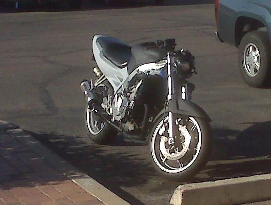

wow this actually helped me out a lot. i was painting my bike last night and came on here and saw this post decided what the heck might as well check mine cus i just bought my f2 a few weeks ago and i changed the plugs but didnt check the coils to make sure they were in the right spots but i guess the origanl owner for some reason swaped the #1 and #4 and it was sounding really crappy but now it sounds great thanks alot for the pic
