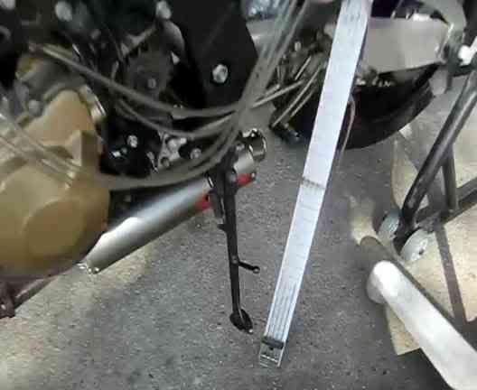

hey
the star-up vid sounded bad cause i had the ignition wires crossed and was only firing on 2 cylinders. And then it was running fine. i have never heard this noise before (or at least not this bad) but i will throw up the videos that i have.
engine speed with the starter was maybe 60-70 rpm. with a piston slap is there going to be any damage? or is that just something that i need to replace the wrist pins? and should i do all of them as a set or just any that are out of spec?
