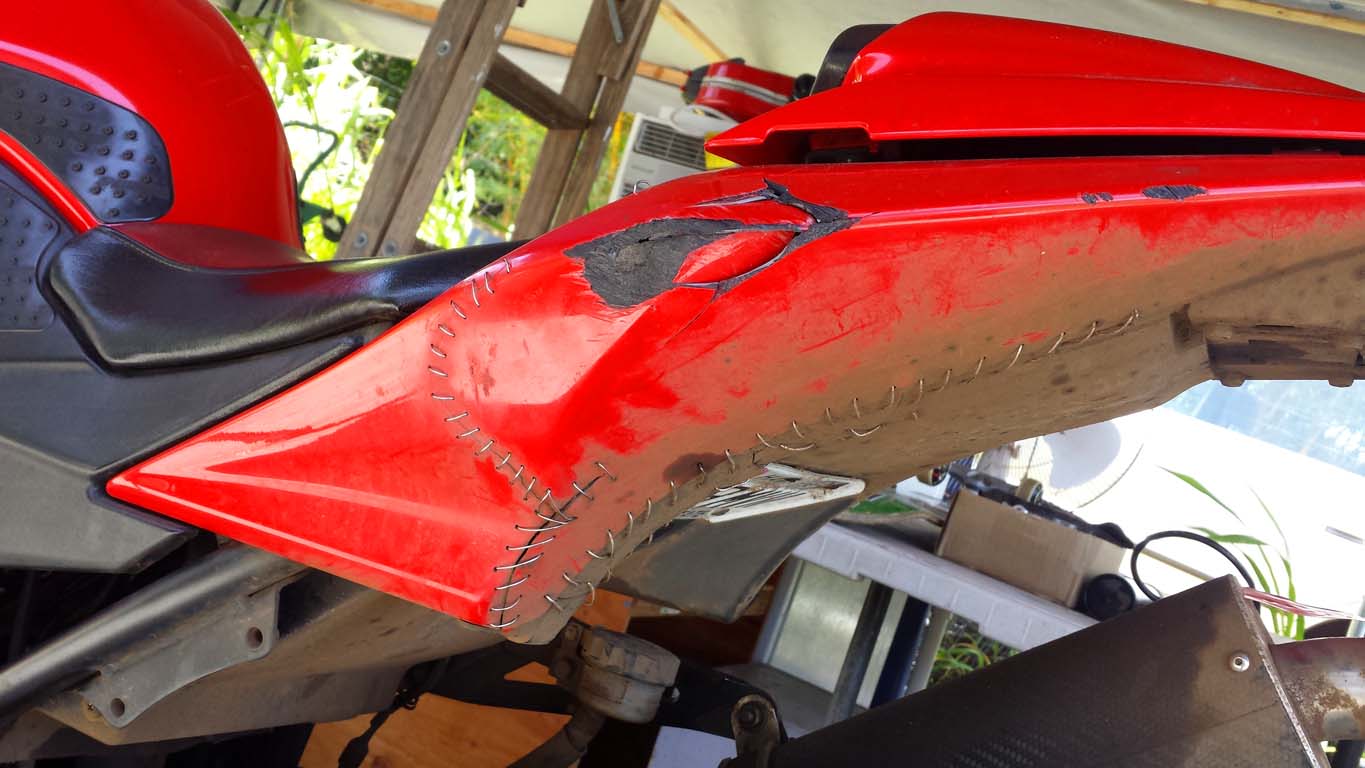

In early days, I tried to repair factory fairings. It worked OK, if crash was minor. But definitely didn’t survive next impact.

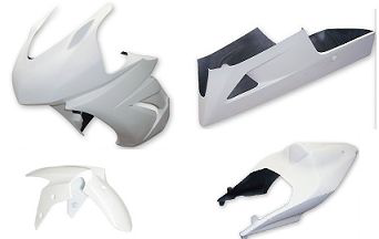

Then I got into racing and needed more durable bodywork. My purple bodywork got destroyed in practice session lowside @ Thunderhill. So I got some fibreglass race bodywork. It also had 2-gallon bellypan as required by rules.
https://12kmotor.com.au/collections/...ck-fairing-kit

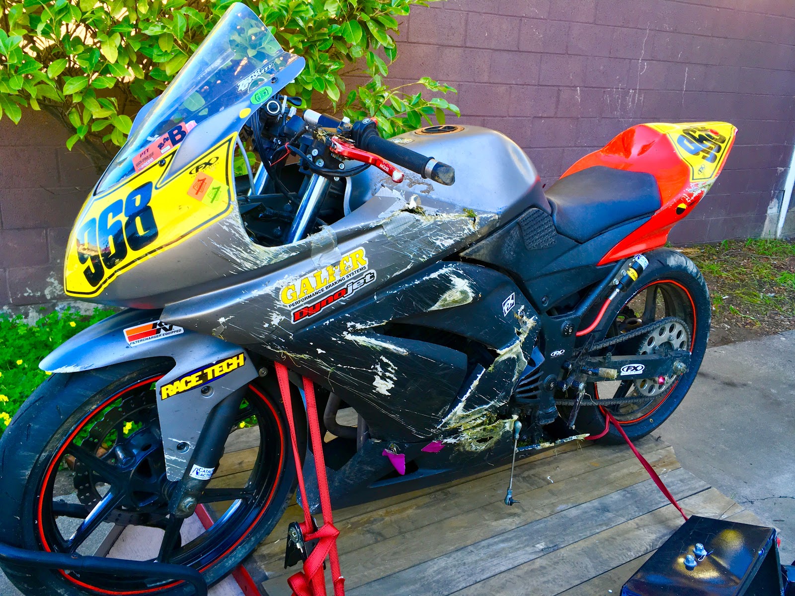

Then came high-speed low-side at Sears Point Sonoma. During LONG slide on grass, I could see that I was keeping pace with riders on track behind me! Was I gonna tumble back on track and get run over?
Nah, stopped in time!
Bodywork had ground completely through in some spots.

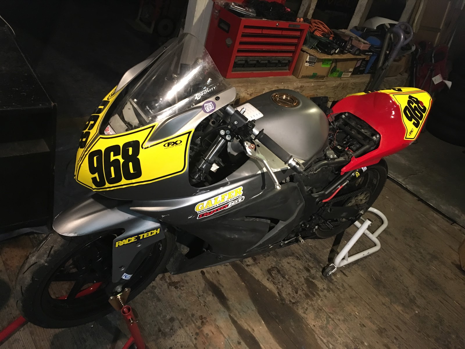

Couple weekends over winter break with full rebuild and repaired bodywork and I’m back on track again!
Uh.. what’s point of all this? Oh yeah, “plastic is plastic”. If you really want good strong bodywork, get fibreglass!!
