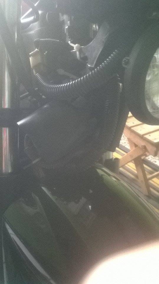

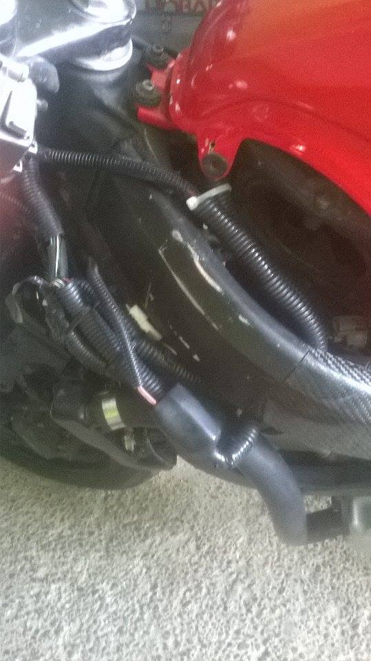

hello people im trying to make my cbr600 f4i kinda like a street fighter and i have these wires by my frame, is there any way i can hide the or place them somewhere where theyre not visible? i need help thanks in advance

You just reroute the wiring under the tank on top of the air box and run it as close to the triple tree as possible.
Sometimes, this means cutting and re soldering wires, but not usually. Zip ties help to route conduit.

get some small split loom and bundle them up that way
