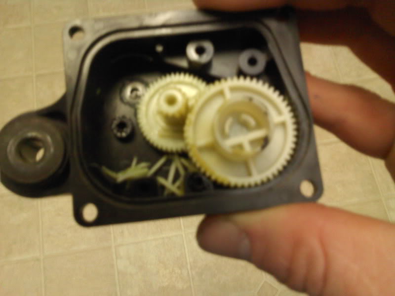

ok so i made some time to take the cables off,, nothing changed so i discided to take the whole servo out, then take it apart too, this is what i found
i do believe its bad
Old Jan 18, 2011 | 09:22 PM
letsride's Avatar
Joined: Oct 2007
Posts: 1,407
From: Central Ca.
Yep its toast. Time for a new one
