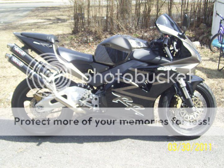

tried to upload map into software to get ready to upload into pc3 so when he gets here with it I could just hook it all up to test it. another thing is I couldn't find my exhaust for mapping. devil high mount shotgun
I downloaded arrow half system retains htev, is there a better match?
