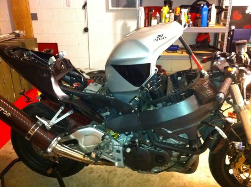

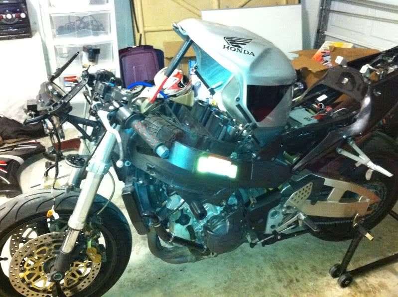

I have a 2002 cbr 954 with 14k miles on it and recently i head about a "flapper mod". With this mod you can gain power in the low but mostly mid range and you can have a slight noise reduction and smoother shifting. Even so, i really need help with a "HOW TO" about this mod. Any help is appreciated.
-SCOTT-
USN
P-3 IFT
here are some links to the "torn apart" bike.
http://i7.photobucket.com/albums/y29...0mods/cbr3.jpg
http://i7.photobucket.com/albums/y29...0mods/cbr2.jpg
http://i7.photobucket.com/albums/y29...0mods/cbr1.jpg
