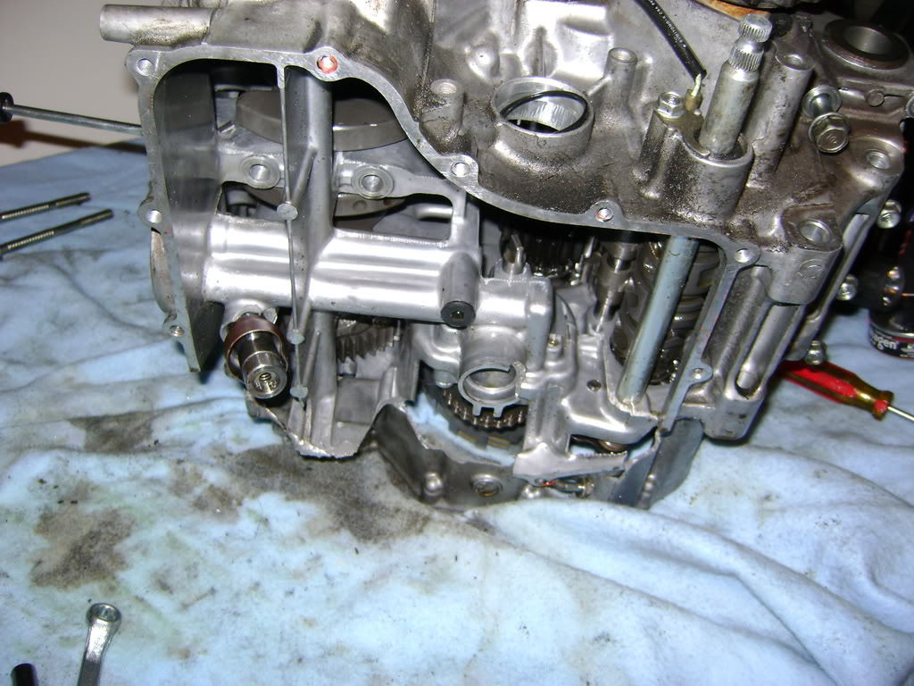

Cheapest is to download it somewhere but I like having the book with me outside. You can start with taking the left and right side fairings off and putting them somewhere safe. The put the bike up on stands (milk crates if your cheap) Drain the oil and then remove the oil pan. This one had other issues but you can see up into the transmission with the oil pan off.
