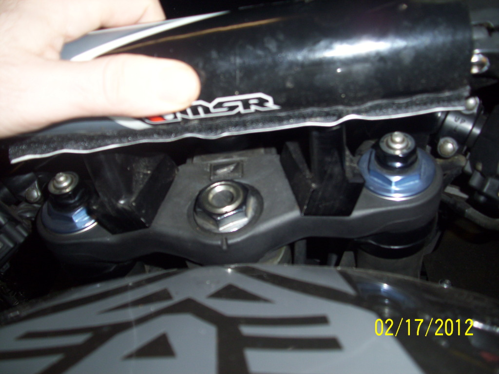

i think thats the type of set up i need due to the lsl kit, i have dirt bike handle bars that only have less then 2" clearence between triple tree and handle bars and wen i called gpr they said i would need 2 1/4" in hight and 3" on width. i was looking at a few brands like u have, matris, sprint and shindy. well it said shindy mounted in fairing but couldnt find a preview, i mean ther all bout the same price a couple dollars off i just want a damper to wer im not looking for another 1 after i buy it and i want it to work with dirt bike handle bars. i really want a gpr so if any 1 knows wer i could get maybe higher spacers for the handle bars hook me up! thanx again!

I have a GPR V4. The body of the damper is about 2" tall plus another 1/4" for the dial for a height of 2.25" above the triple tree. From looking at your pic width may also be a problem. The GPR V4 is nearly 3" wide at its widest point near the top. Your setup appears to narrow towards the top.
thanx alot im going to check it out and ill update progress
