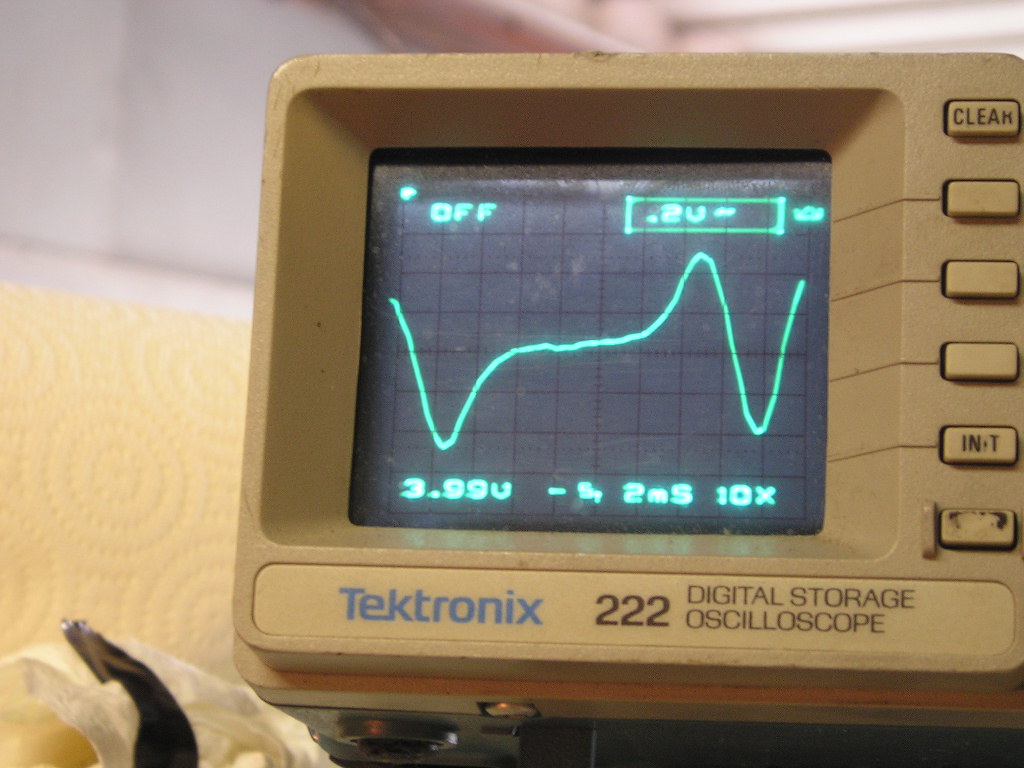

Due to short interval of injector & coil pulses, blink on test-light may not be long enough for human eyes to see. Solenoid light would be better as it has duration-extending circuitry to keep light lit over 100ms for human eyes to see. Oscilloscope can also be used to probe injector/coil wires. Looks like this, high most of time with short drops to ground to fire injectors & coils.
