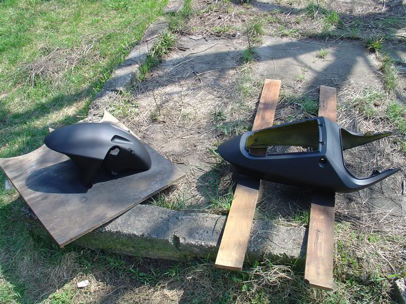

Here are some side projects.
Broken tab on the rear plastics, I welded it together with a soldering iron, and painted it:
