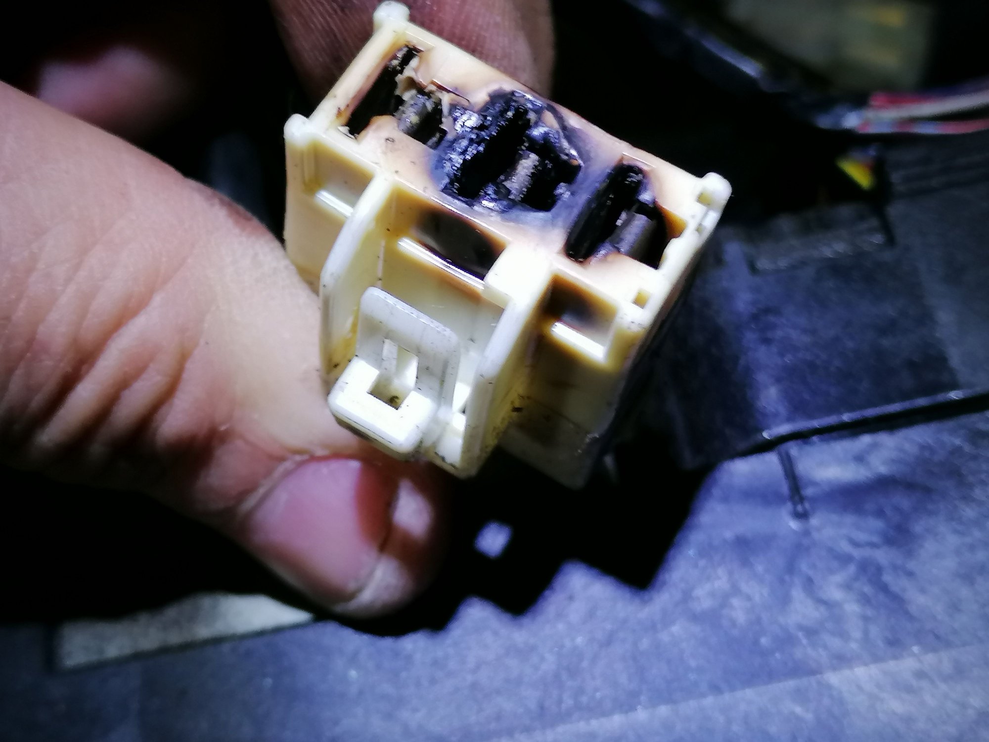

Hmmmm, that would explain it.
Now the question is, what caused it?
I cut the Connector off and stripped the Wire ends.
All three have continuity to Ground (Battery Earth Lead), so it looks like I'll be rewinding it . . .
Old Oct 11, 2021 | 03:36 PM
Most of the time, it's corrosion that builds up between the metal blade of the connector and the female portion. If that is an inline wiring connector, then replacing the connector plastics along with the metal pins would be the route to go. So long as the pins are of equivalent size, then it really doesn't matter what connector you use. However, if you're replacing the Stator and it comes with the connector on it, then you're going to need the one that matches. That picture looks like the wiring harness side and not the Stator side.

As mentioned, there is continuity to Ground on all three wires, so I'll need to rewind it.
I'll probably just use some good quality Bullet Connectors, and shrink wrap them with the adhesive-lined stuff.
The other option would be to just solder them, there's no real need for it to be quickly detachable.
Old Oct 12, 2021 | 04:51 AM
Since all the wires in the Stator are ultimately connected to each other in the windings, its often that all will show a short to ground. If you rewind it yourself, post up some photo's of your progress. Would like to see that. as for the connections, soldering would certainly eliminate a melted connector.
