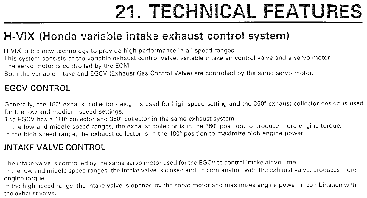

When you say HTEV, is this what you're referring to? And which parts do you have installed that are still functional and which are not?

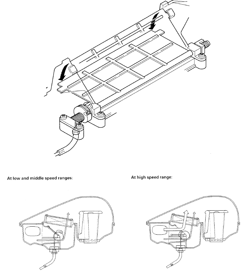

So the components in this image are missing? They've been missing for a period of time and you were not experiencing this issue? When did this particular issue start up? Any work prior to that?
