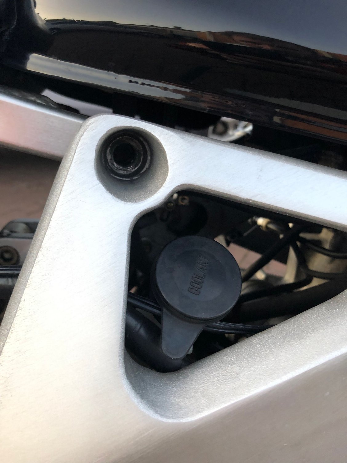

Took it for a spin and when I got back, realised I was missing a bolt out the subframe (right hand side under the seat)
As I’d taken some photos of the bike when I first collected it, I checked them and the bolt was indeed there. So it must have worked itself loose!
my question is. Where can I get a replacement without spending nearly £80 on titanium ones. I’m trying to keep the bike original, so stainless/aluminium will be good.

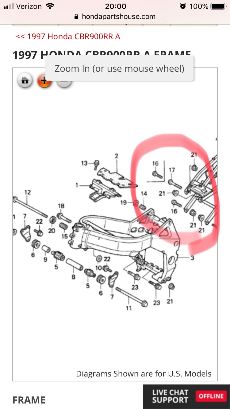

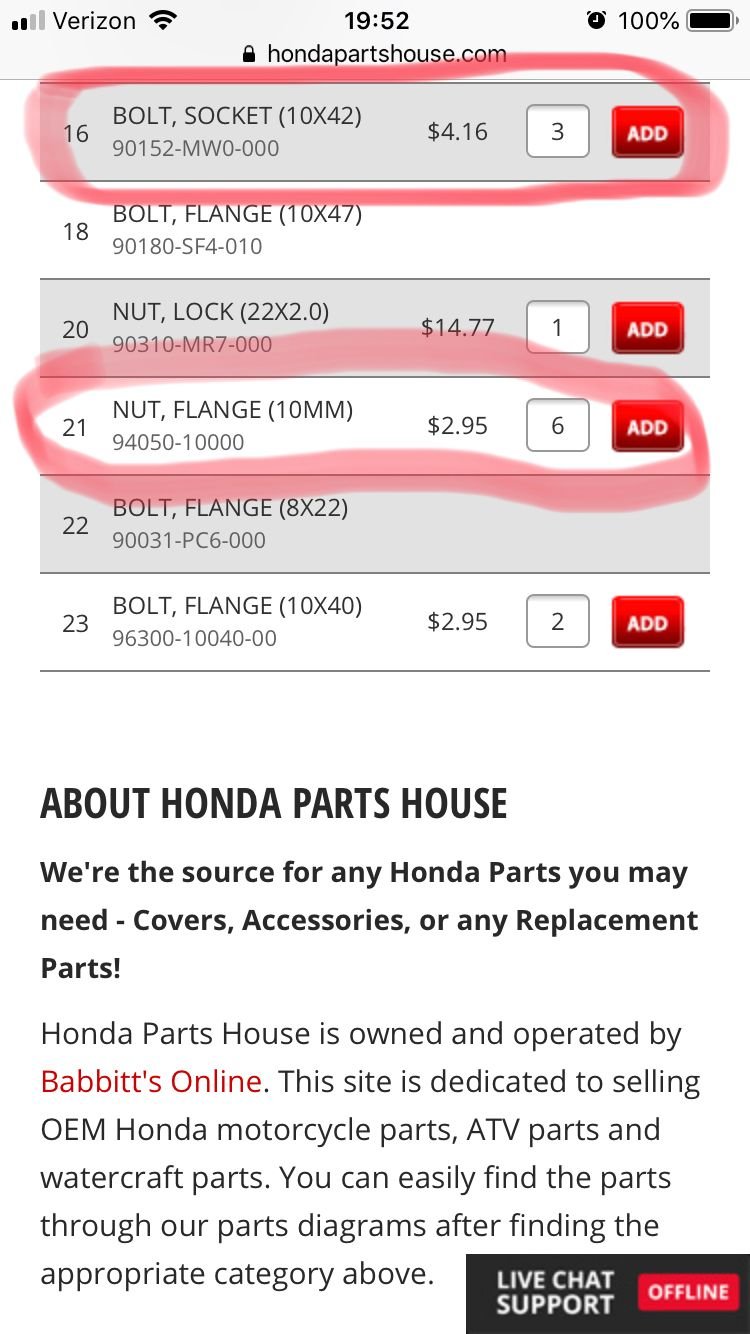

If I understood your question correctly here are the two part numbers needed for the 96-97’s.

Cheers guys. I followed the link and they are the bolts I need but am in the UK and that was the US site.
I have been able to find the UK equivalent and ordered the correct bolts.

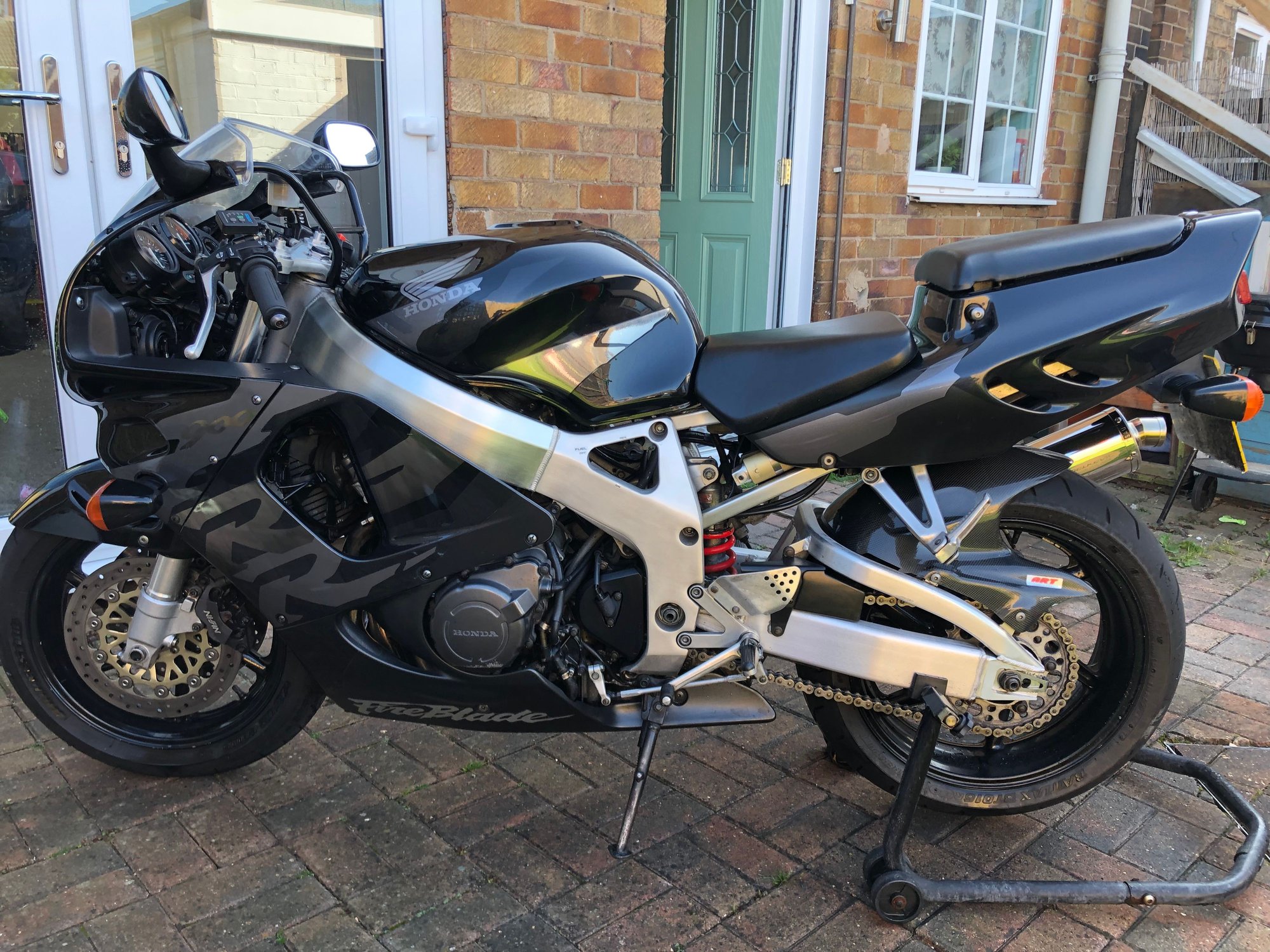

This is mine. Noticed it’s missing the “cbr” decal on the tail. Possibly it’s been scuffed and just removed. But wondering if it’s had a new rear at some point??
Bike is HPI clear though and rides straight so cant have done too much damage if that’s what’s happened...
or perhaps the nut and bolt genuinely just worked itself loose?
