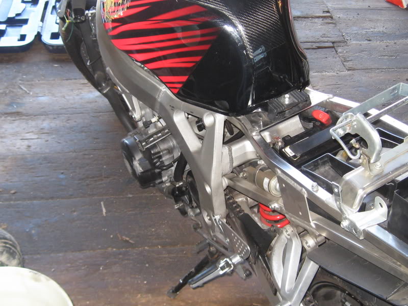

My model doesn't seem to have a dipstick, just a cap on the topside of the right side cover and the oil level window below that. From whatI could see looking into the engine, everything looks great.
The mirror bracket is what I was talking about, andit has 2 sets of rubber o-rings for each hole. It also has a 'sleeve' for the long bolt that holds the tank down. Worst comes to worse, I can just throw a few plastic/rubberwashers in between to tighten it up...I just thought I was foing it wrong somehow. The rubber rings look beat, they may just be compressed from 10 years of abuse. The bracket needs to be bent just a little and then it should fit the fairing fine.
The fairings I am most certain are Factory, since they have Honda on the inside of them and look identical to the pictures I have seen online. The headlight is supposed to stay on the fairing as you have said, but the previous owner took it off for whatever reasons he had, and I didn't know any better to place it in first before adding the clips on.
Tonight after work I'm going to grab a bunch of body clips at Wal-Mart, as well as some cheap oil to do the change and see if it does anything. I have all the hard bolts I think, it is the lack of clips. The old bolts were placed in the spot they came from when he took it apart, so I'm happy about that
Looks like I'll be working on this till midnight or later if my hands can take the cold
I don't know how pics work on this forum, but here are pics from earlier today:

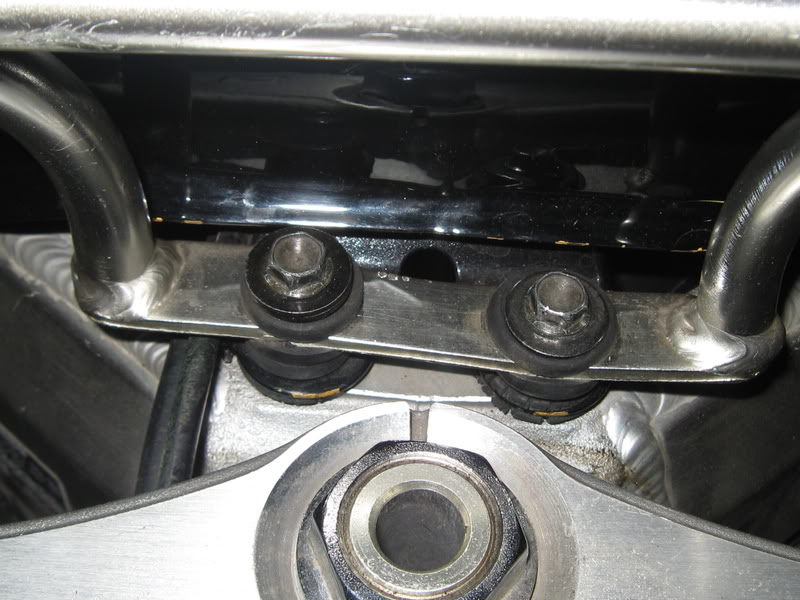

Alright, if someone could help me with this, it would be greatly appreciated. The mirror bracket is loose. I even added a 3rd Rubber bushing to maybe get some pressure on the mount by the tank, and it is still loose. Any ideas?
Also, Which way do I mount the tank and the bracket? Does the bracket go under the tank mounts? I have the bracket over the tank mount now, and the tank vibrates on the frame like it should be lifted.

Dude, looks like the bike landed on the bracket when it fell (looking at the scratches on the top), and its kinda twisted. Placing the bottom section in a table vise you can tighten it slowly so that it may bend into a flat piece again. With the table vise holding the bottom piece, twist the arms very slowly until the are semmetrical again. Do this very slowly and in small increments as fast twisting and large increments will weaken the metal.
