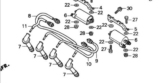

Old Nov 9, 2021 | 06:00 AM
You're plug wires are routed like this?

Apologies the plug was slightly wet when removed not soaking, im in the process of changing the coils over.
