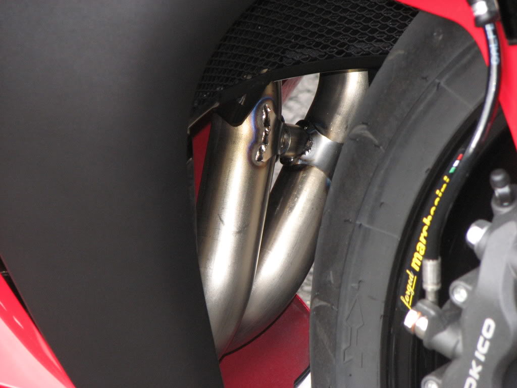

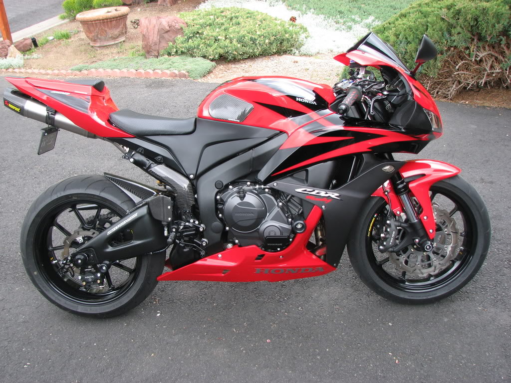

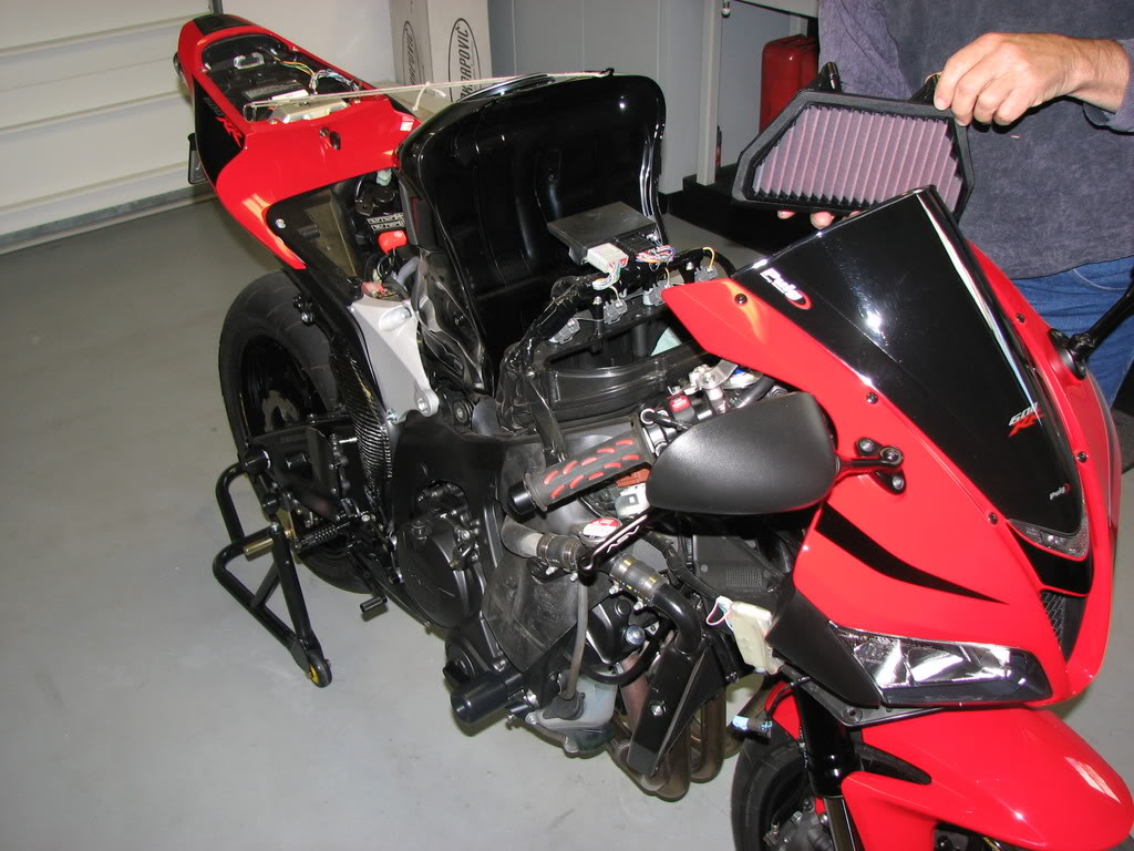

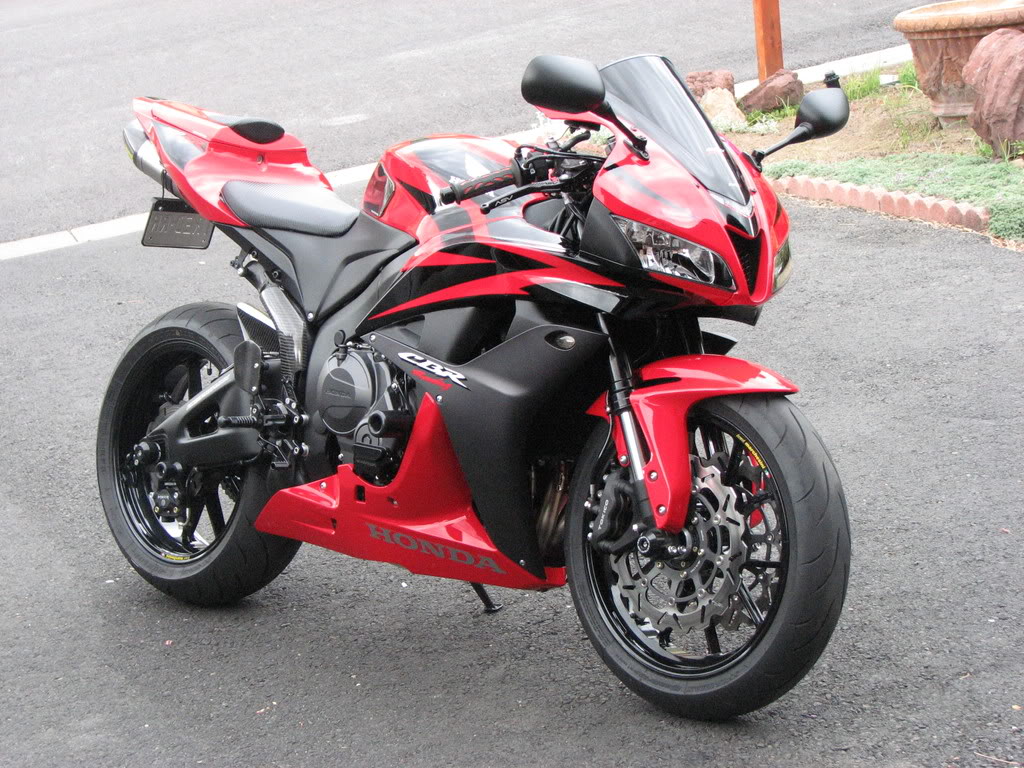

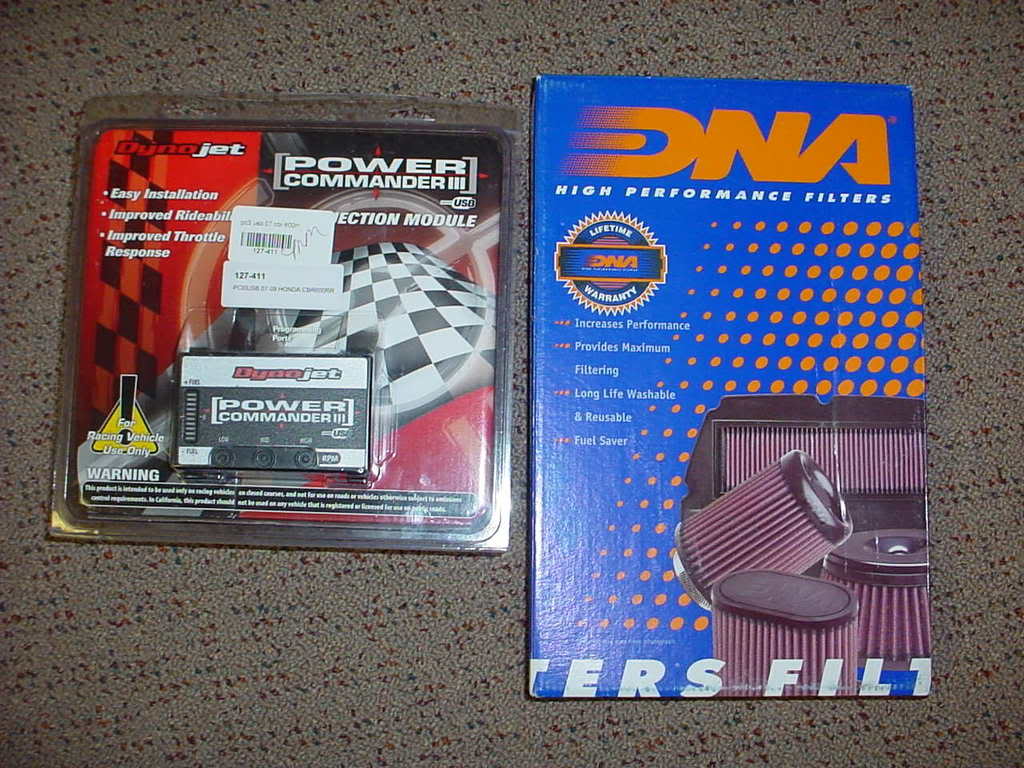

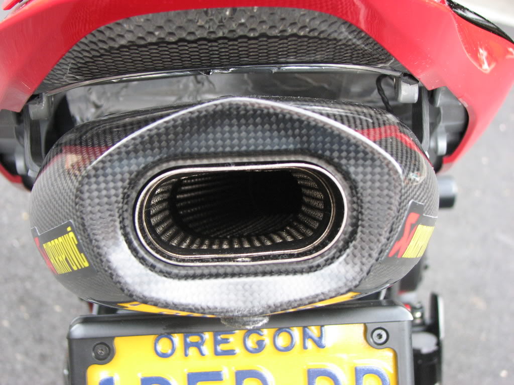

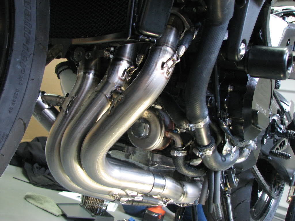

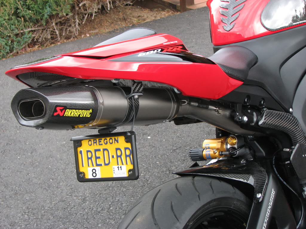

Got some goodies in the mail...will make multiple posts since i'm not sure what the limit on pics are now?!?! Got the Akrapovic Full Titanium EVO Exhaust with a PC III and a DNA Airfilter. Also installed Gilles lifters.

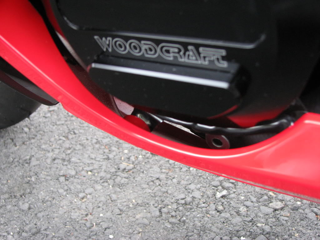

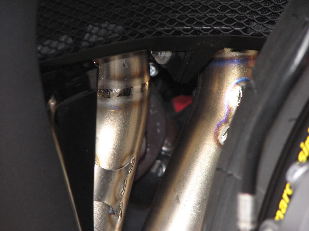

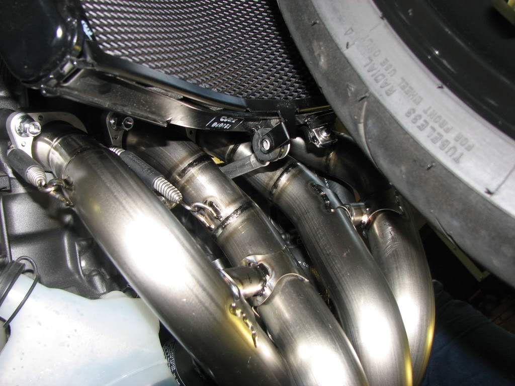

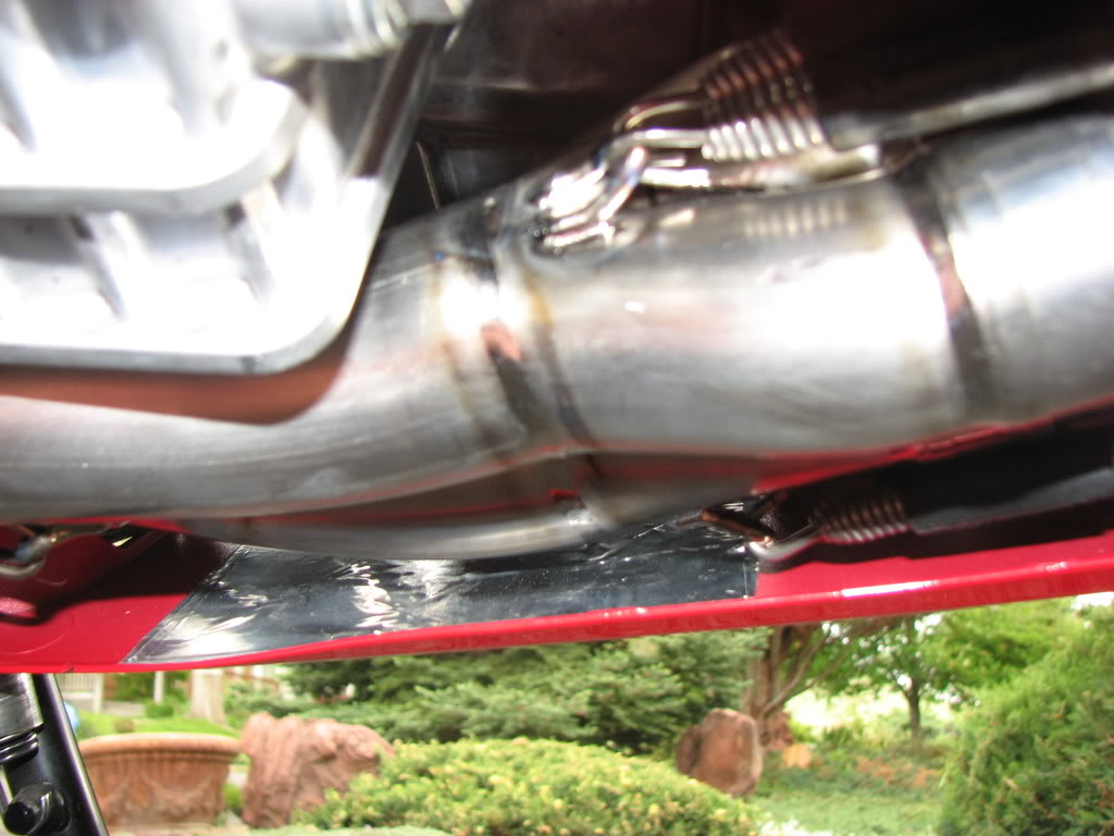

Because the header has such a large bore...you run into fittment issues with the lower and right mid fairing. So i Pulled of the bracket that is on the alternator cover, turned it around, ground of the nut and reinstalled with some heat foil. Gave me about a 1/2 inch of clearance. Also the right side mid fairing triangle is close and i put some heat foil in there also.

exhaust shield is powdercoated...will let you know...but it just flies..cant believe the gains...video with sound..hmmmmm
